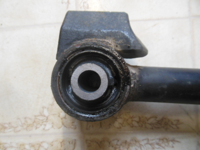

Rears
Demonstration purposes ONLY: If you are attempting this repair, do it at your own risk.

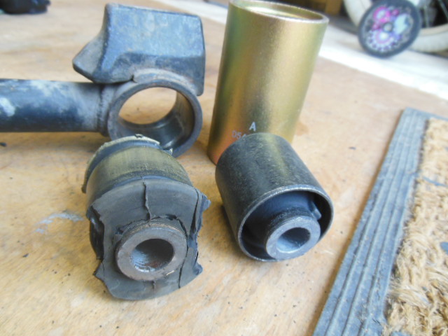

Started doing the rear suspension.

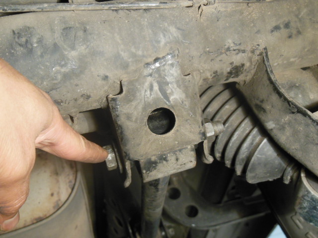

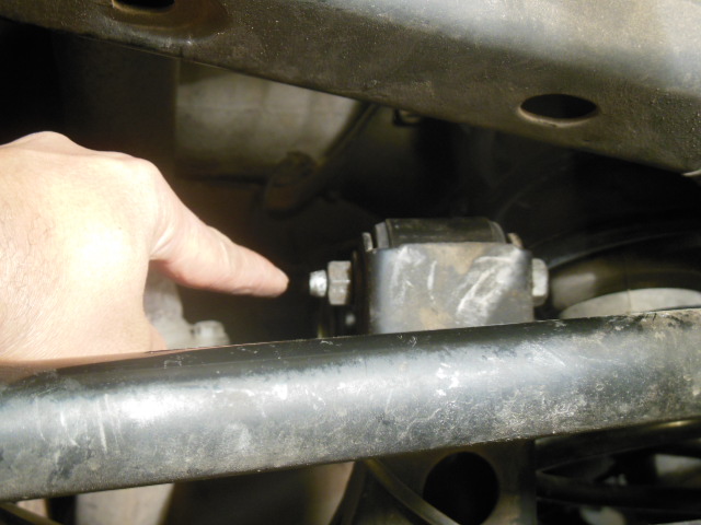

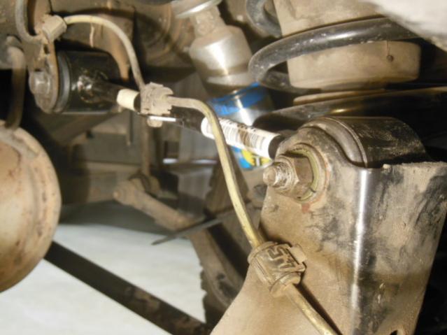

Important: Kept the wheels on Ground, front wheels Choked and REMOVED ONLY ONE CONTROL ARM AT A TIME.
Break loose the BOLT in the Lower Arm and NUT in the Upper Arm last 2 images in Post-9, WHY? (There are notches built on the nut in the lower arm and bolt in the upper arm that bites into the mounting brackets and those won't turn).
Loosen (BUT DON'T REMOVE) all Nuts/bolts on all 5 control arms to guide the bolt through the frame. I did not use any straps to align arms.

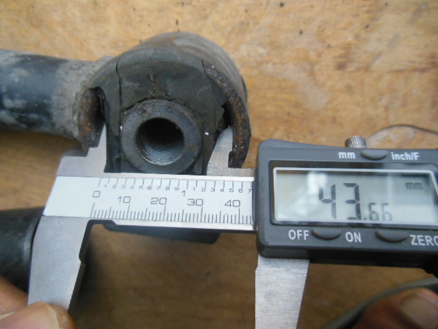

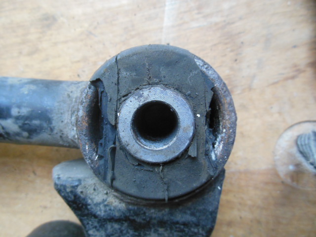

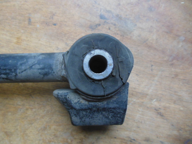

All took about 2.5 hours. New bushings were installed into Rear Lower arms. Bought upper arms so no bushing replacement were necessary.

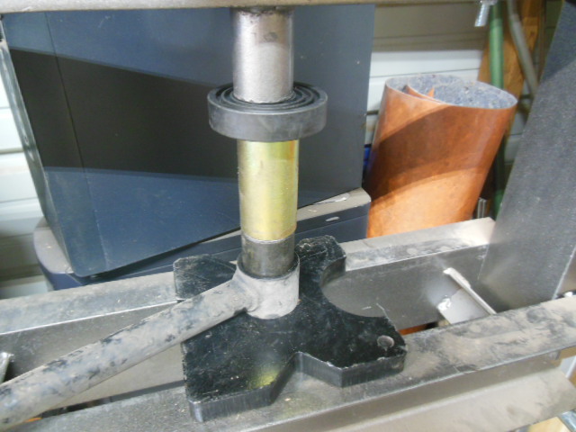

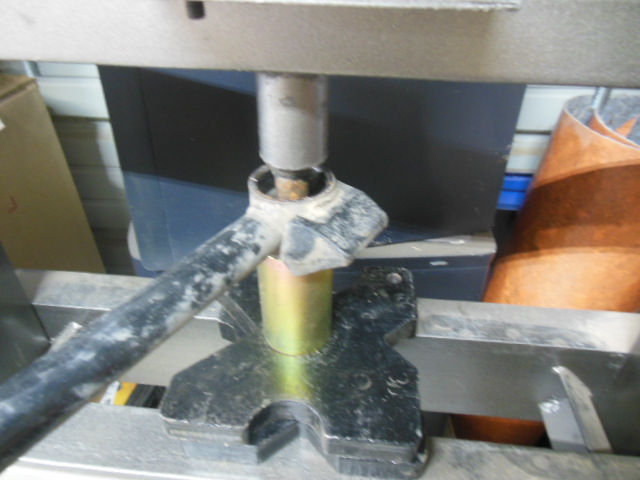

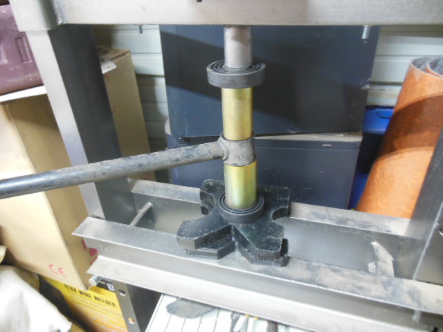

I used a press sleeve kit

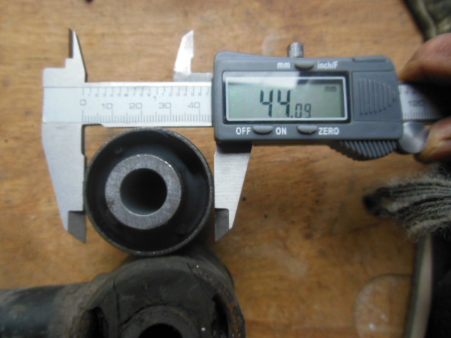

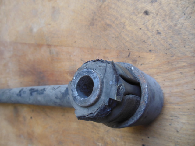

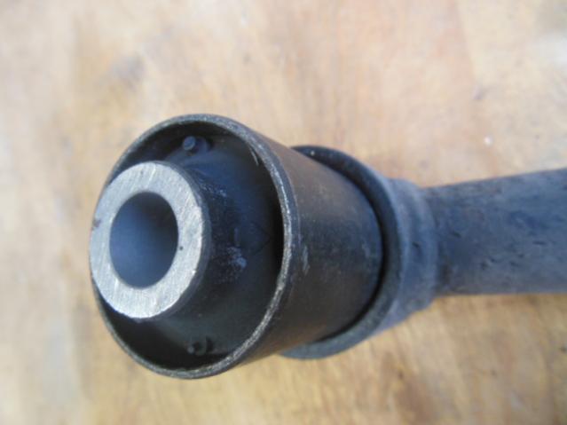

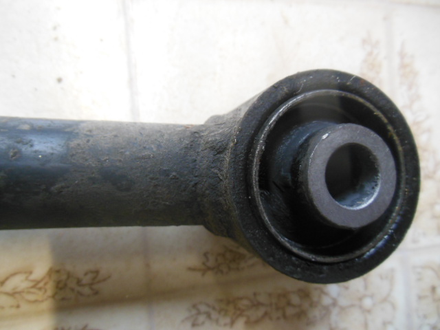

Installation

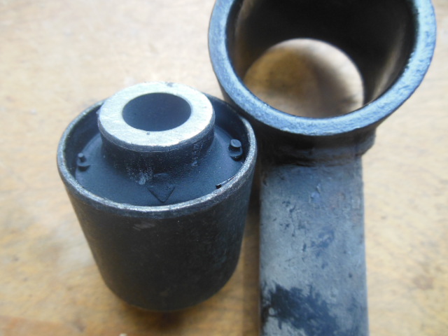

The Arrow marked on the bushing should lineup with the arm (see the old bushing above to note the arrow's direction)

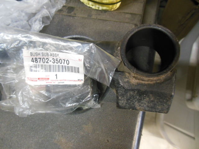

Bushing number : 48702 - 35070 : goes to either end of the lower arm
4th Picture (with one press sleeve) shows the initial driving of the bushing into the arm: Make sure the bushing is straight to the arm. Drive it until about 0.5 inches left. Then, use the second press sleeve 5th Picture to catch the bushing coming out on the other end.
Last 2 pictures: Note the "Arrow" orientation

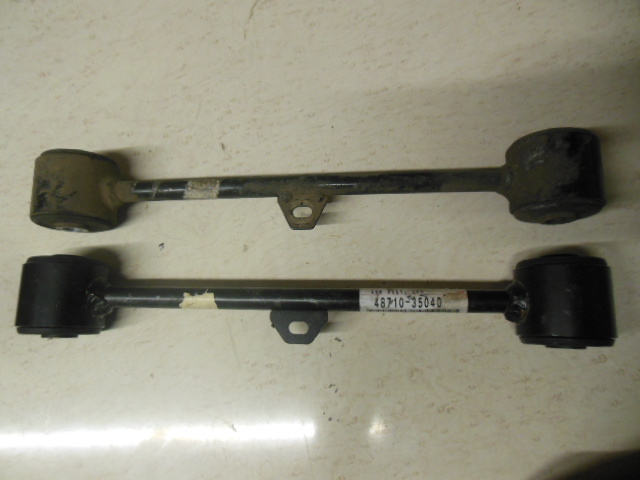

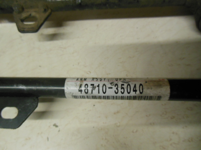

Rear Uppers
Rear uppers
Last two images show the BOLT (in Lower Arm) and NUT (in Upper Arm) that needs to be loosen first.

Well.. all the parts I have listed for my 97 4x4 SR5 works 100%. It has been some time and not sure about the bolt holes, but if you get the exact parts, then you should be fine. Make a note of how the rear lower bushings are pressed into the arm. There is an arrow and that should point to the front and the air gap is placed parallel to the control arm (arrow will then point to the front): Last two pictures in post-8.
Also check with parts diagram given in the partsouq.com
