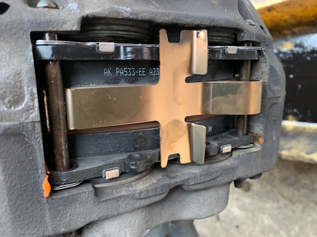

Is this enough brake pad left? I think so but I keep hearing this very faint swishing/scraping....not a squeek. I will say that the rotor turns ok most of way but is hesitant in one part of the turrn. I don't feel any warping when I hit the brakes.. Damn these sounds! PS....I looked at Yotatech and found a thread where NorthRidge Toyota in Cali was giving 25% off parts w/ free shipping. Something to look into! I called the parts manager and it's true. Front pads were $33.97!

- Looks to me like you have a reasonable amount of pad life left.
Hard to tell with a pic.
My new still in the box Toyota front pads for 15in have 11mm of pad....on the plate.
How many miles on your truck. Probably unlikely you have a stuck piston. How do the rotors look ? 15 or 16in wheels ?
Yeah I thought so too, I am just digging for answers to this faint noise. I have done enough brakes in my day. I don't think it's a stuck piston because it's still moving. 62K and 16" wheels

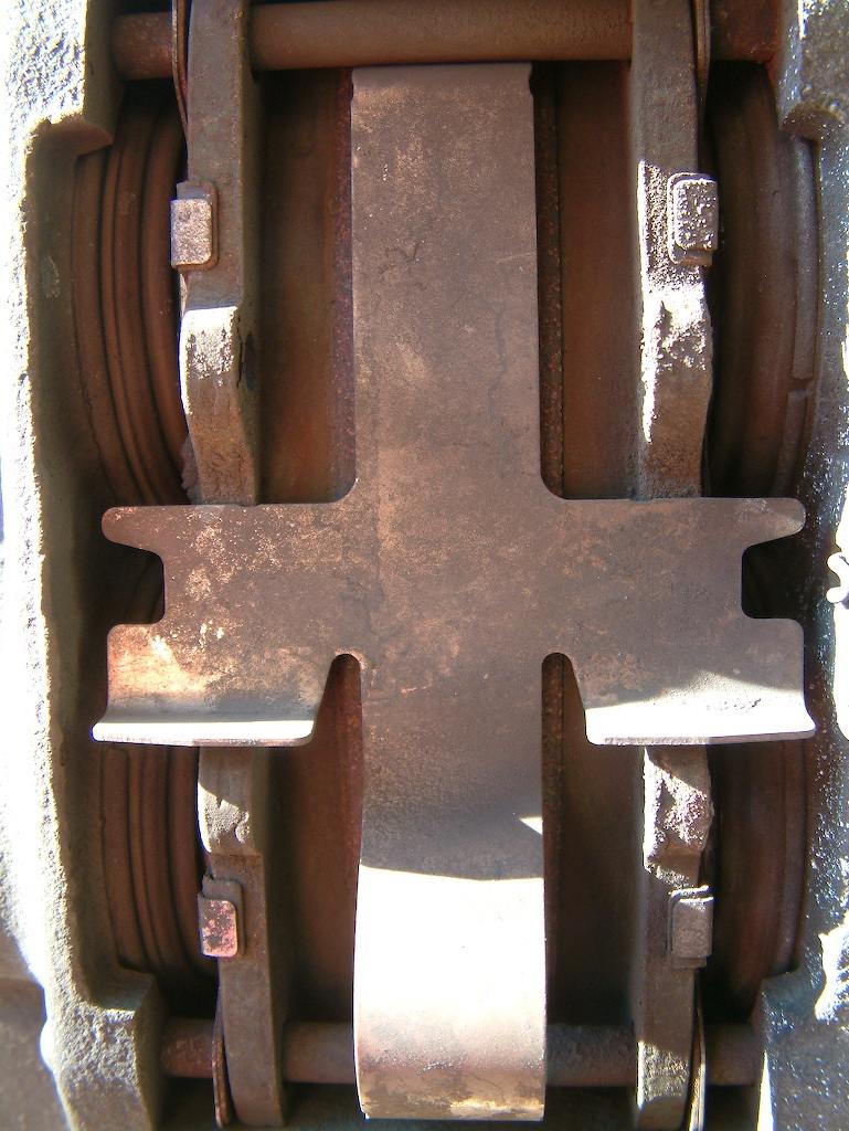

a. Large Spring Clip on Front Right Assembly was anchored only on top Caliper Pin Guide pin. (See Photo with correct Clip Orientation: Large Curved bottom of clip was not locked behind bottom pin).

1. Severe wear on front pads indicate cheap non-OEM pads were used. Left side Pad uneven wear probably related to incorrectly installed Spring Clip.
2. Replaced Front Brake Pads with Toyota OEM brake pads with shim kit and new large Spring Clips.
3. 4Runner was test driven for 5 miles with series of 40mph-to-5mph braking sessions to 'bed the brakes'. Slight brake pedal pulsing noted BUT NO MORE Steering Wheel Shake nor FrontEnd Shudder!
Bottom Line & Lesson's Learned: Non OEM 'cheap' pads and incorrect Pad Shim/Spring clip installation can cause braking problems!
