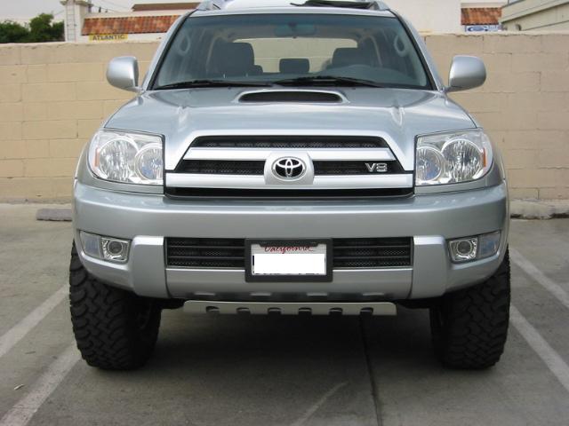

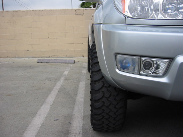

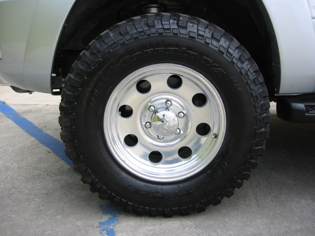

Finally got the BF Goodrich MT KMs.
The wheels are 17x8 Eagle 058 wheels with 4.5 back spacing.

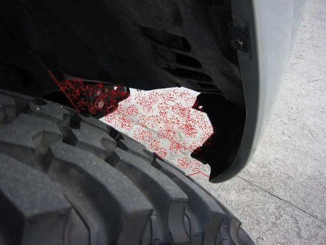

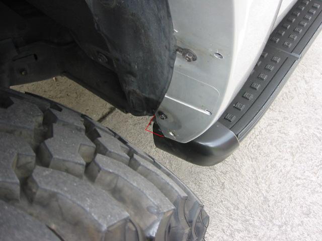

Had to do some trimming. Just as I thought, even thought the Revos and the TA MTs were the same size, the TAs have a wider profile, so I had to cut some of the front fender liner and a bit of the wheel well trim.
The red area is where the liner would have been before cutting.

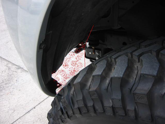

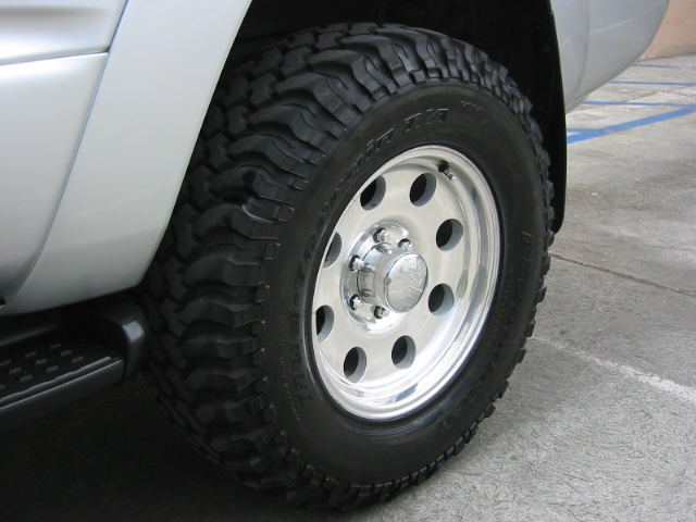

Driver side front (corner where the mud flap was) trimming.

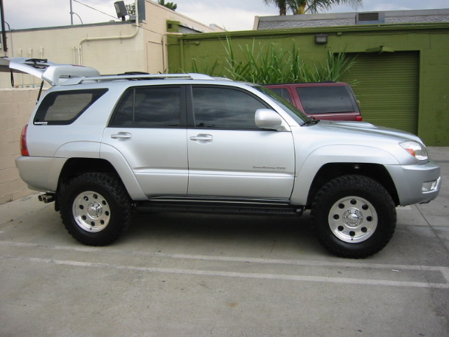

Side view
I'm thinking of powder coating the wheels black or metallic blue(cobalt)... What do you guys think?

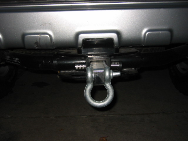

I also got a hitch shackle to keep away people that park by "sound". Maybe I should have gotten one that's got two shackles..? No such thing... Maybe I should custom make one. It looks like the 4runner got only one cojon(es). :D
those tires looks like they bite and grip. nice.

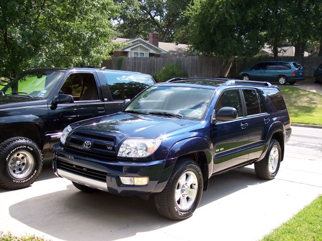

Awesome! My favorite posting Ive seen and read yet. Your 4Runner is one of the nicest ones Ive seen anywhere (web or the streets!) AND Dont touch those wheels either!
Im a newbie, just got my 1st 4Runner and love it. Infact as many great cars and trucks as I've had in the past I cant remember a one now since I got this baby!
Im thinking about getting a 3" suspension lift like yours but was concerned about the ride quality. How does it compare to the original factory suspension? Am I going to sacrifice comfort and smooth handling for rugged looks and improved off road capabilities?

I could feel the ride to be little bit stiffer in the beginning, but after a month or so, I couldn't remember how the old setup felt. Got used to it quick.
If you're going to stick with stock tire size or a 265/70s then the spacer by itself should be just fine. If you intend to go with bigger tires, I suggest a body lift along with the spacer to clear the tires.
Spacers are cheaper, but since you don't have to save xreas, you might want to save up and do a whole suspension upgrade. Costs more, but it's more effective, I think.
I'm not an expert by any means... But this is what I know.
Hope this helps. :)

This is just an idea. I think if you powder coat the step or the side of it in silver to match with the roof rack so the step doesn't look out of place and the black standout too much.
