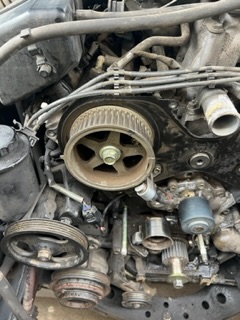

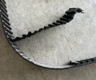

New to the forum! It’s awesome there’s such a huge community on here! So having some issues doing a timing belt job. My son over filled his oil(2 qts), drove it for a few days. While driving, lost power and died. He was able to get it restarted and drove another few miles before it finally died and wouldn’t restart. Took off the top TB cover and seen the belt started to split(pics). We tore it apart and we’re trying to TDC and the R Camshaft Pulley will not budge. We were able to get the L Camshaft Pulley and Crank all TDC but nothing further. All fluids were good, no peanut butter oil or antifreeze.
3.4 5vfze SR5 4x4- Manual Transmission
Any ideas on why a single camshaft would lock up and not the other or crankshaft?

Something broken and seized. Might have to pull the valve cover and investigate. Camshafts are not known for seizing.
Be careful with the Camshafts. If you pull the bearing cups, make sure you put the service bolt in and keep track of where everything goes.
Edit. That ripped the belt in half. You have something majorly wrong on that head. Its locked by the looks of that belt.

I never seen a 5vz head do that before.
He didn't suck in water or hydrolock a cylinder did he?
