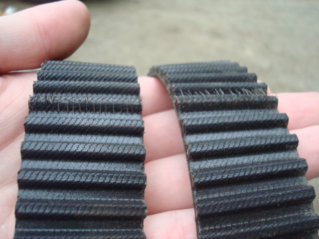

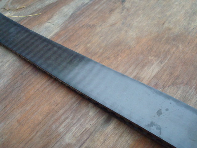

Anyway, I'm gonna leave a couple pics of the old timing belt here.

That belt in the pictures is not a 90,000 mile belt by any means. There is 131,xxx on the meter and I have to think there are just as many miles on that belt. The t-belt pulleys were OEM and none of the hardware appeared to have ever been touched.
Also, the plugs were definitely never replaced and all of this leads me to believe the scenario I just typed out is a real possibility.
