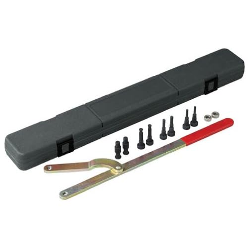

anyone know if this tool will work?
Amazon.com: OTC - UNIVERSAL PULLEY HOLDER & FAN CLUTCH SET (4754): Automotive
Do they have those at the AutoZone free tool rental? If so you could try threading one of those posts into your front crank pulley.
