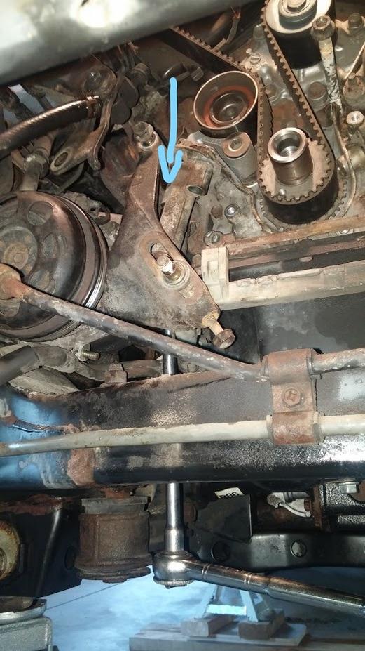

Can't find a write up for the special tool you can make to get the tensioner bolt off or the part number for the tensioner bolt. Can anyone help with that?
From what I understand, you just get a 1/4" drive universal (wobble) and a long extension, and you can just unbolt the tensioner from underneath without having to remove the A/C bracket. A good TB kit should come with a new tensioner, so ne need to actually compress the one you have. Hope that helps.

Tensioner
I had read it is possible to remove the tensioner without removing the AC bracket. I had removed the AC from the bracket but was struggling with the bracket which lead me to find that option. It involved using a 1/4" drive 10mm socket with a 1/4" universal joint (wobble joint) with a 12" extension. I converted from 1/4" to 3/8" with an adapter at the end of the extension. There is space coming straight up from underneath to access the rear bolt. I've attached a pic I took to try to help anyone else that tries this option. I had tried different angles of attack before I found this angle and it was relatively easy. I believe it would be possible to leave the AC bolted in place but not certain as I had unbolted it already.
Is this also valid for a 3rd gen?
