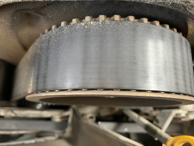

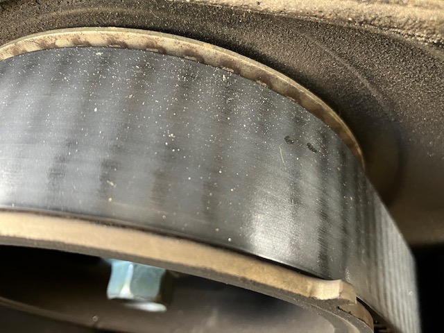

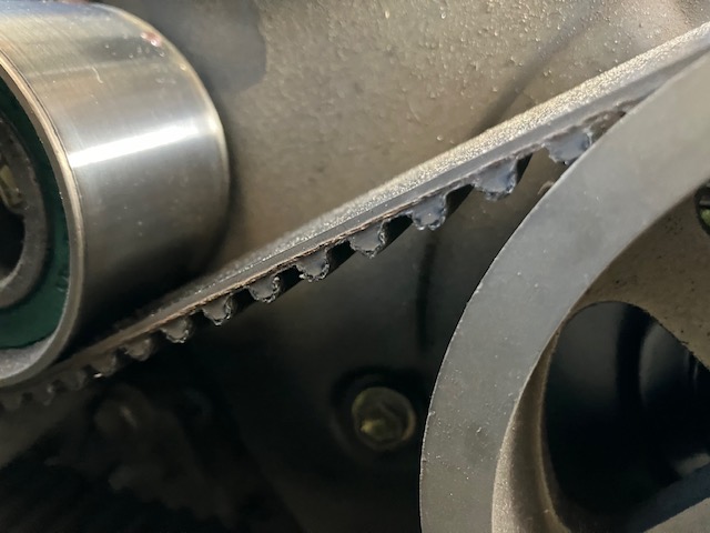

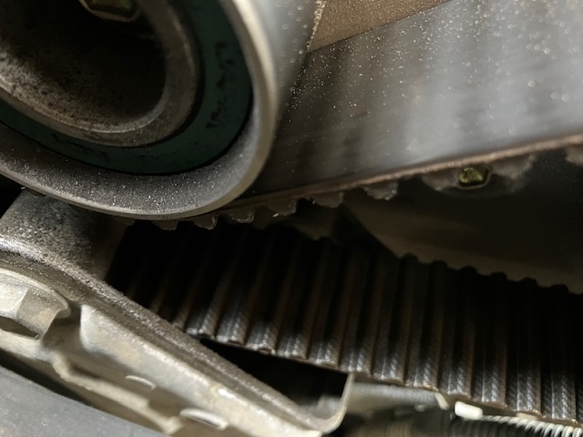

I really appreciate the replies and the insight. For reference, this belt has 66k miles on it, however it's 13yrs old. Thus far, there is no indication of any water pump issues. I posted mainly as I have no frame of reference as to what an old timing belt looks like. Perhaps it doesn't look new, but it doesn't look like an old, cracking drive belt either.
Did my '96 at 120K, and while it apparently didn't need it based on appearances, I felt better knowing it was done, considering the age of the material itself, if not the miles.

The Toyota official interval is 90k miles / 6 years. That is pretty conservative if you use OEM parts - anything beyond that is up to you. The engine is non-interference, but who wants to be left on the side of the road?
