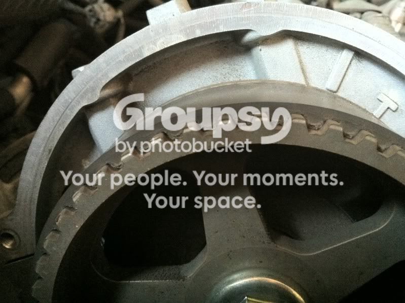

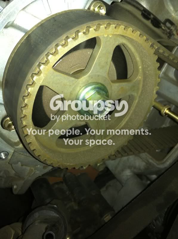

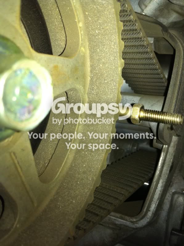

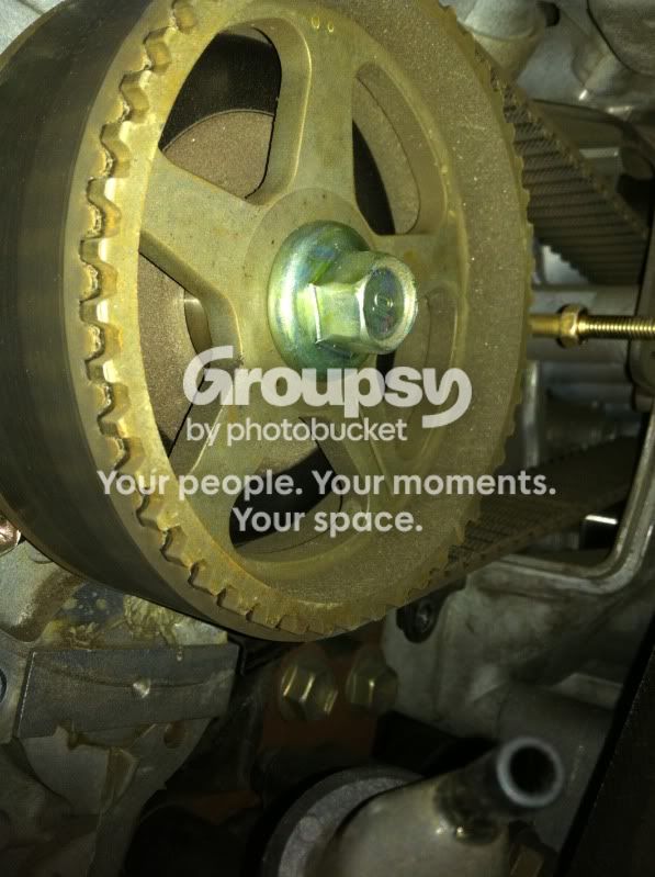

So I just purchased a 2004 4runner v8 4x4 limited and I don't believe the timing belt has ever been changed. The truck has 136,000 miles on it. I took the cover of the passenger side cam and was wondering if you guys could tell me if the belt looks ok to run until i get it changed. To me it looks fine, but I dunno.

Sometimes belts don't show any physical evidence of wear before they break, I'd say anything after 90k is a gamble but some people have gone twice the interval without replacement.
The pictures you're showing appear to have a part number on the belt... you can attempt to compare that part number to toyota part numbers to verify if it's a genuine belt or has already been replaced by an aftermarket part once. Genuine belts are possibly (but not definitely) original, and, aftermarket.. well, you might have some time.
As for what I'd look for - I'd be looking for small cracks where the teeth of the belt meet the flat part. You cannot determine this from the picture provided. Also, don't dare twist the belt to view this, you'll likely damage it.

When I had my timing belt changed the mechanic told me there is usually a date/code on the belt that indicates its age. May have to turn it over a couple times and see what you find.
