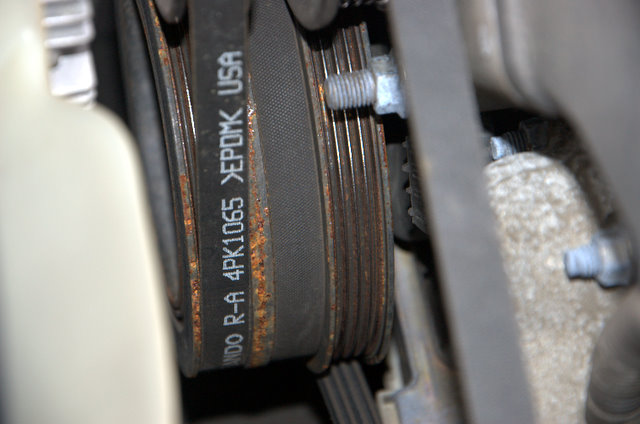

Had a chance to look under the hood today since the weather cleaned up a little. What I saw was not good. For some reason the pulley is extremely rusted. I'm sure that's the reason for the noise.
But why did it rust? Shipping container salt? Water pump failure? And how do I fix it now is even a bigger issue.
