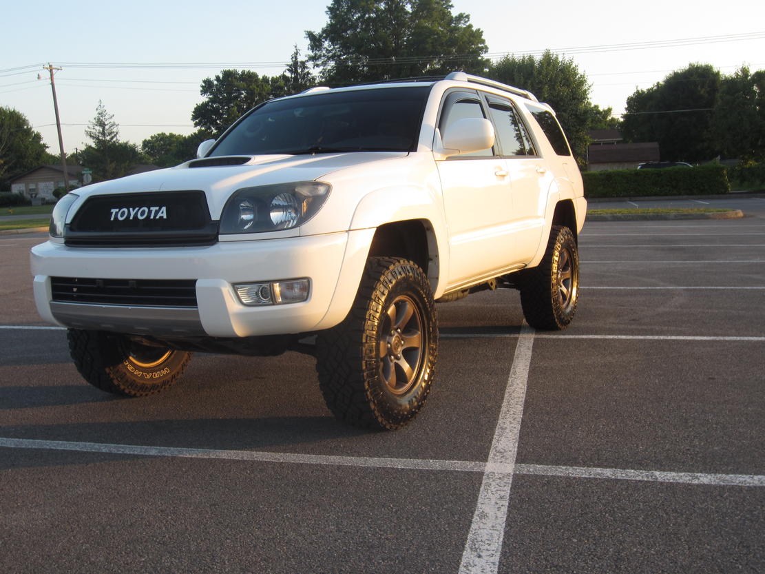

I've been wanting to make a mesh grille for a couple of years now, however, the difficulty of fabbing one for the '03-'05 body style has kept me at bay. I finally secured a special Hilux grille off of another member that makes it much easier to build a mesh grille. Using that as my backbone, I began to put something together...

I went ahead and shot it with some satin black fusion paint to cover up some of the wear. I'll be having the lower cross bar either wrapped or painted to match my natural white paint, so I wasn't concerned with making that part look perfect.

Just finished cutting out the mesh. Did most of it with a dremel w/ cutoff wheel and a bench grinder. Brushed some Plasti-dip on the exposed metal to protect it and help it blend in.

Got the grille mesh mounting all sorted out, so I decided to mock everything up and throw it on the truck. I'm really liking the look. Now it's off to get painted.

I was giving up hope for one to look that good but it has been done. Now I want one like that! Great work!
Any issues so far with the hood latch?

That grill has holes and all for the hood latch already, since it is a Hilux grill. No issues at all with me for the length I had it.

Thanks! As Sparky said, the grille is a direct bolt-on: no modification required to get the grille itself fit/function correctly.

I don't think I'll end up mounting any serious lights behind it, but I may end up doing the triple amber marker lights (Ford Raptor-esque) depending on how it looks.
Mounted some amber LED marker lights today; now they're ready to get wired up. I still need to get the thing painted though; waiting on my paint guy to contact me back. :playball:
