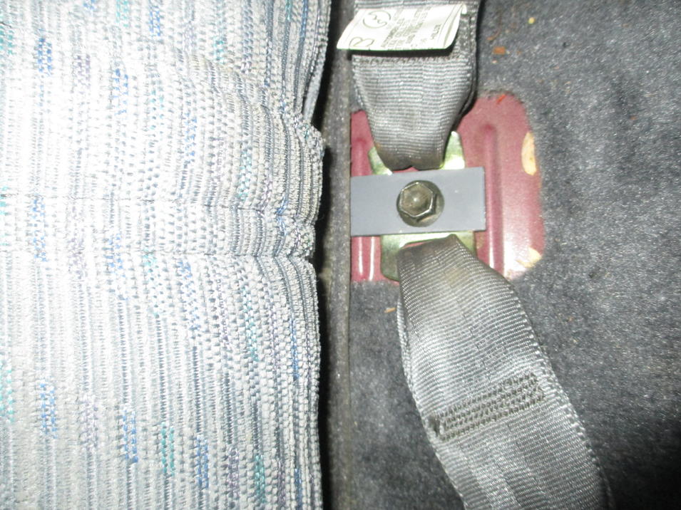

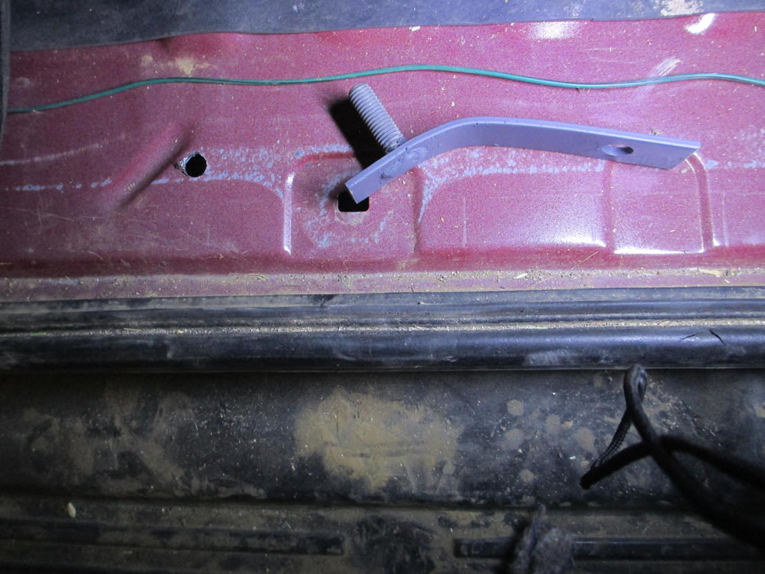

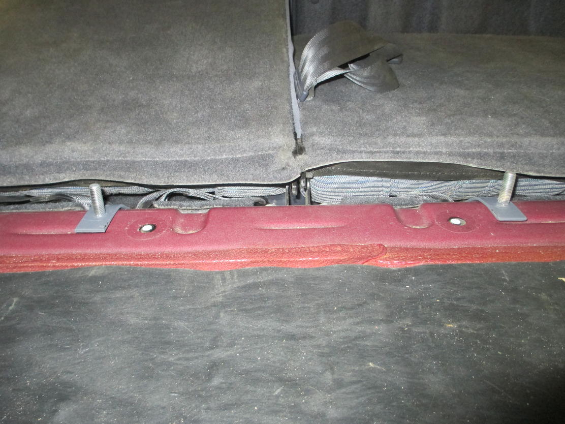

I needed to keep the rear seats but I used the same seat belt bolts with a simple bracket .IMG_2045.jpg
