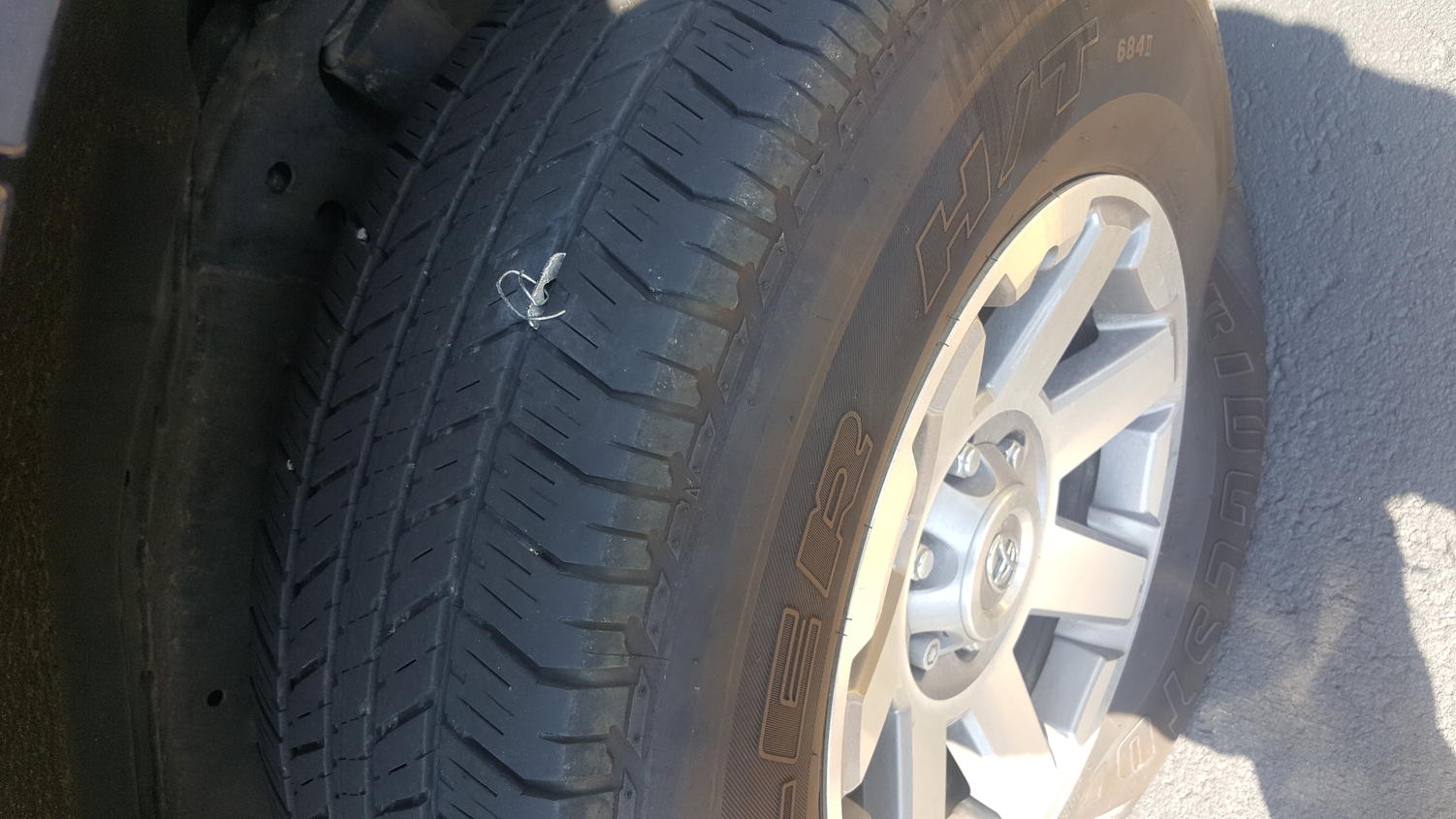

Not having much luck with cars right now:( Blazer has a brake light on and now
5 minutes ago driving home, braking before hitting a turn I hear
BRRRTTT BRRTTT BRTTTT then it stops.
Get home, go around to the passenger side to see if it was just something on the road - there is some sort of metal thing stuck in between the treads, lots of hissing and watching the rear tire go flat.
Will have to call AAA and have it towed to a tire place. The current tires are original 2015 Dunlops, car now has 50,000 (bought this used about 4 months ago from a dealer). So there is a decent amount of tread left on the front....assuming this isn't pluggable
So first question is replace the 2 rear only or go all 4 (ouch).
The tires look like that after 50,000 miles? I was hoping they wear a little quicker as an excuse to get a new set. I only have 22,000 on mine after almost 3 years of owning.
Being where the puncture is, I don't think that is considered sidewall.
You should be able to have an inside patch if the tire isn't too bad on the inside.
Do NOT plug your steel belted radials!

50,000 miles on oems is a gift. There is no way I'd spend a penny fixing that tire, the siping is gone and the tread depth appears to be where (3/32) replacement is recommended. Although they "look" OK, they cannot be good in the wet.
My .02 is for Michelin LTX, but you sound averse to spending much. Do you have a Discount Tire nearby? - I've been very favorably impressed. I caught a sale, and a Michelin rebate for $160 off. Free rotation and rebalance every 5k.
maybe the photo is misleading, but that tire does not look like it has a lot of life left in it. i would just go ahead and get new tires

I would plug it only if I had no spare and just to make it to a tire shop to get it patched on the inside.... Some patches also have a plug to plug the hole and patch the inside too.
If you are on a trail and it was an emergency, then plug it.

Personally I would have it plugged if the shop can do it safely and just keep going with it.
If they say they can't fix it, put the spare on and then think about the options.
