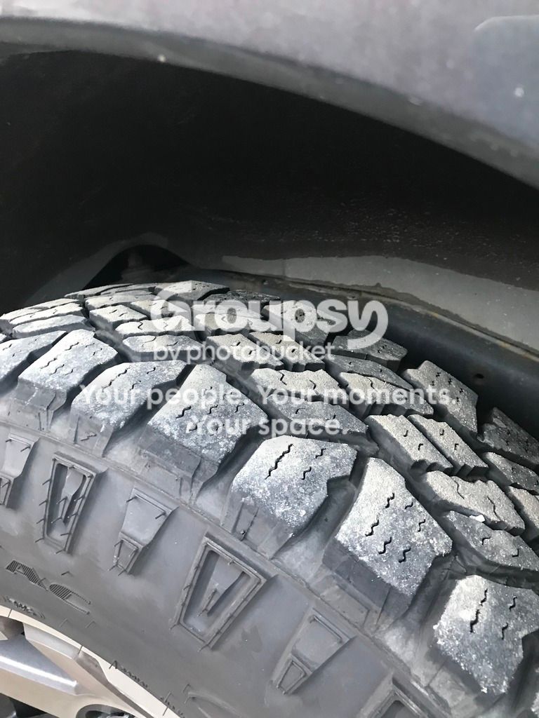

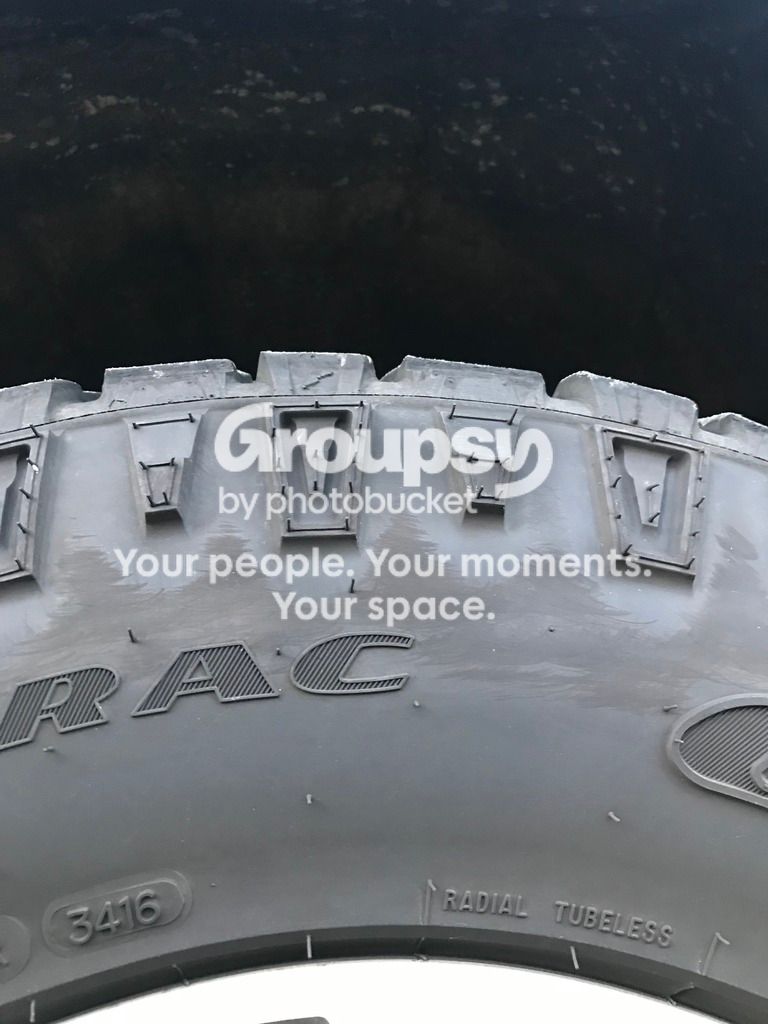

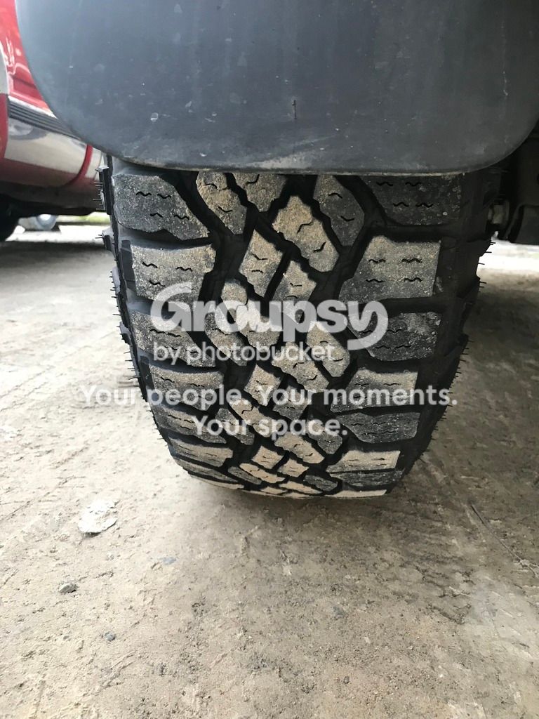

Photobucket is only letting me post one picture for whatever reason, but you can see that certain treads are not contacting the ground like others. The dirt on the other two tires have equal coverage on each tread. I have a picture from the side of the tread blocks but photobucket won't let me post. If anyone knows a better place to upload and embed photos to the forum for free, let me know..

Edit* seeing your new pic, they don't look bad.

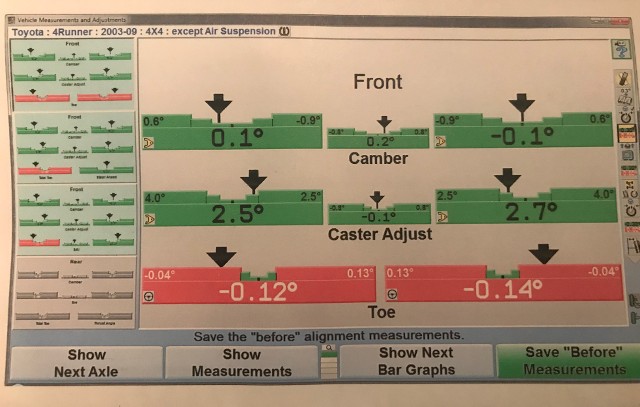

Maybe you could post the results from your last alignment. Most shops will give you a before-and-after print-out of what they achieved.
Toe-in is by far the most important alignment spec for tire wear. Camber is next, and caster is almost irrelevant in that regard.

Could you take pics
of the alignment results, SIZE THEM DOWN and post them here? for reference.
Here is my most recent one. In all of the alignments my right toe would go out of spec. This most recent one has both toes going out. Not sure what would make only the toe fall out of alignment..
