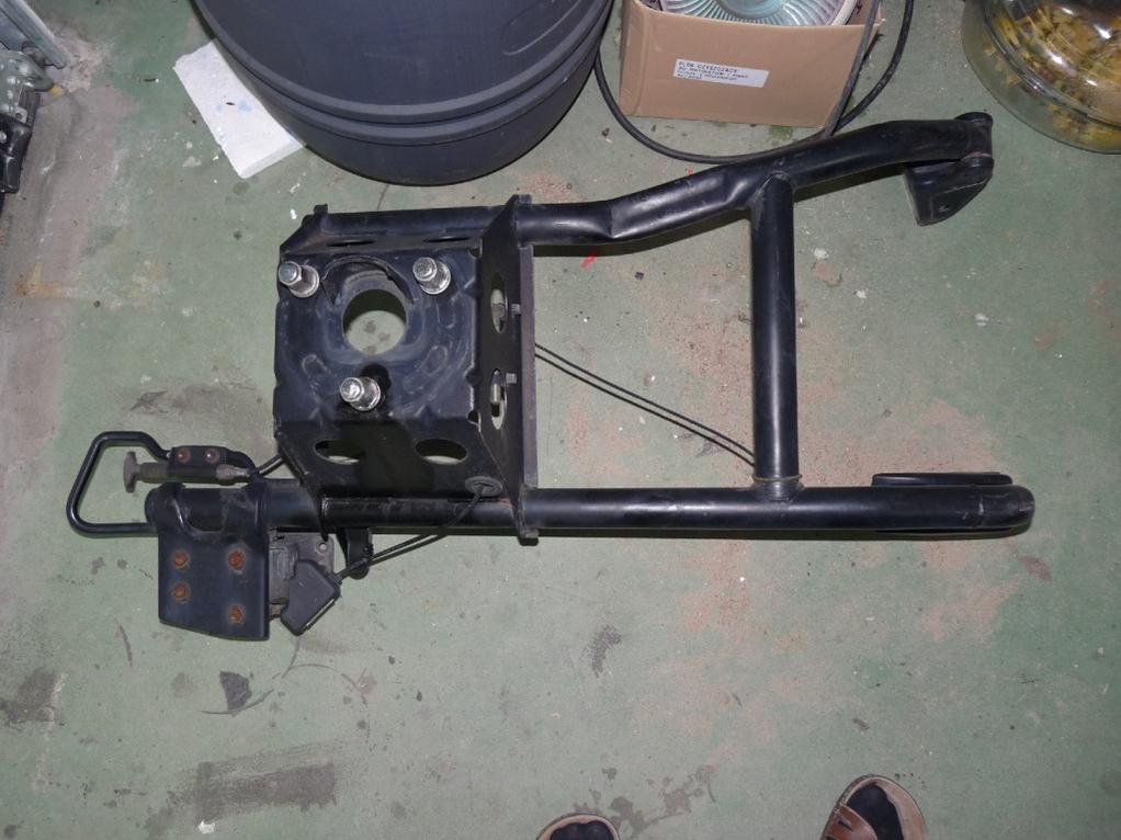

Since I am really thinking and planning at this point, I figured I should also consider what is really my FIRST choice, and that is the factory option that was available over seas. If I could just get my hands on this, I have no problem making the necessary support for it. I love the look of it,and it goes with the factory look that I still have on the rear. I just don't know where to get one.
anyone know how to get the tire carrier and the latch without buying the entire rear hatch?:shrug:

Second gens have a factory tire carrier, is the body shape close enough that you could adapt those mounts for your use?
The hatch is different enough that it is not a great fit. I have found a guy in England who has three of the 96-02 hilux surf tire carriers and he is going to get me a shipping quote. I figure I can find a couple of people on here who want to do something similar and share shipping costs...

It all fell through....
