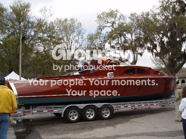

My understanding is LT's can be 2 or 3-ply sidewalls. If they are 2-ply they're obviously some heavy plies with lots of rubber. If 3 ply the material may or may not include a full steel belt casing. A full steel casing is much harder to find. In searching for trailer tires for the boat below I chose these: http://www.bridgestonetire.com/tireselector/GlamourIndex_BS_EN.aspx?productID=1121, Bridgestone R250s. In my research I learned 3-ply is easy to find. True truck tires, the ride be damned type, sometimes offer the normal steel tread plies plus one steel ply that wraps all the way to the bead. I chose these Bridgestones because 3-ply (1 steel) sidewalls and all the curb scrubbing this rig does.

EDIT: No, that's not my T4R pulling the boat :lmao::lmao: And I repeated mostly what Falls & Thai wrote as I was uploading the photo and doing my two finger typing:D They're too fast for me...

CJ , Is that your boat ??? OMG it is beautiful !!!! Give me some specs on it . I will share that pic with my dad , he will melt in his shoes. Last time I drove something like that was a few years back and it was a 1947 Chriscraft ( not sure of spelling ) . Much smaller though. Would love to see more pics or email them to me .
It's my bosses boat. It's a 36'x8'6" Hacker built by Hugh Saint Custom Boats in Cape Coral. The boat was commissioned for build as a Hacker triple cockpit open boat. The original buyer ran out of money and my boss walked into Saint Custom Boats and saw it circa 2001. With the aid of Hugh and Charlie Janus (Blackfin and many others) turned it into a commuter style attempting to stay faithful to John Hacker designs but in a 2005 kinda way. Hacker made some very similar boats. This boat was made with the intent of "what would John do today". It has two HO8.1L Crusaders w/ZF 2:1 reduction transmissions. It is seriously overpowered. With 16 people it'd yank 3 skiers like it was nothing. As we were spec
Thanks , thats just beautiful.
