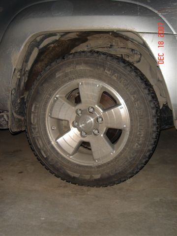

What's the biggest tire size I can go on my stock 07 sport edition rims? Without rubbing and will fit my spare tire compartment?
Thanks!
I have 255/75R17s and they rub in reverse when I turn the wheel all the way to the left or right.
I have 265/70/17's Revos , never had a rub , fit fine , look much better and fits fine in the spare area.

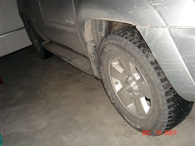

here is one
I don't have a spare that size. But the difference is minimal. Hope this helps...
