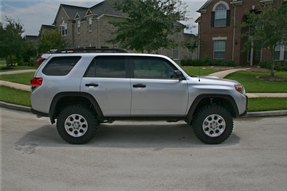

I did a search and could not find anything that addressed the happy medium. I am looking to swap out my stock tires for something just a little more aggressive and a little bigger. I ordered the Toytec leveling spacers and want to fill the gap without destroying the ride. <insert flame here> I love the look of Tflow's but cant quite go that route...any suggestions as to what I could throw on that will look and perform better than the Bstones that I need to replace because the dealer refuses to acknowledge them as defective??
http://www.toyota-4runner.org/attac...282701127-post-your-lifted-pix-here-after.jpg
not sure i understand your meaning exactly, but if you're just doing a front spacer to level it out i don't think you're going to fit 285s like that...
I am just doing the spacer to level out but also have to replace the tires on the SR5 rims. I know I cant have what I want (the link to the pic) but I am looking to replace the stock with something just a little more aggressive and bigger than the stock bstones...
The biggest you can get, thanks to Harper7, with the level with no rub is 275/70-17. Its a little bigger and you get get BFGs AT for the little more aggressive.
