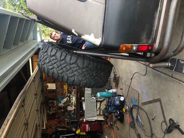

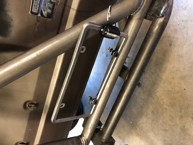

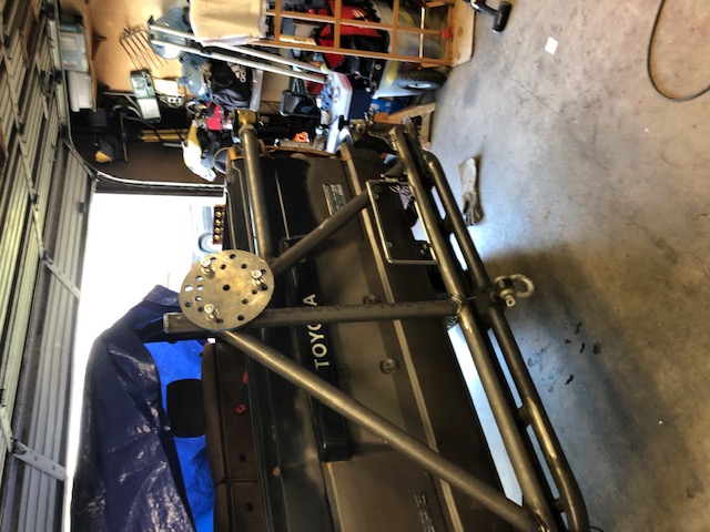

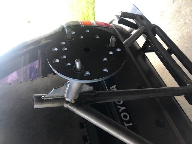

I just thought I would throw up some pics of the tire swingout my sons are building on a Trailgear rear bumper.
FYI, I have a 96 4runner, my middle son has this 86 4runner, and my youngest son (the welder in the family) has an 07 4runner.

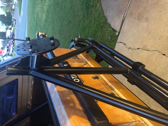

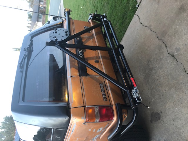

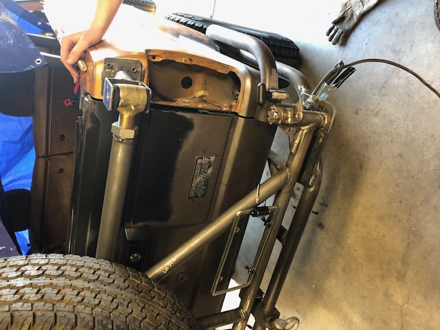

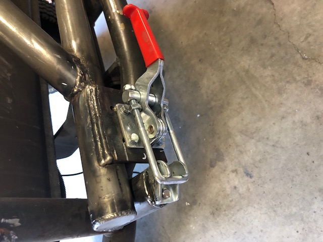

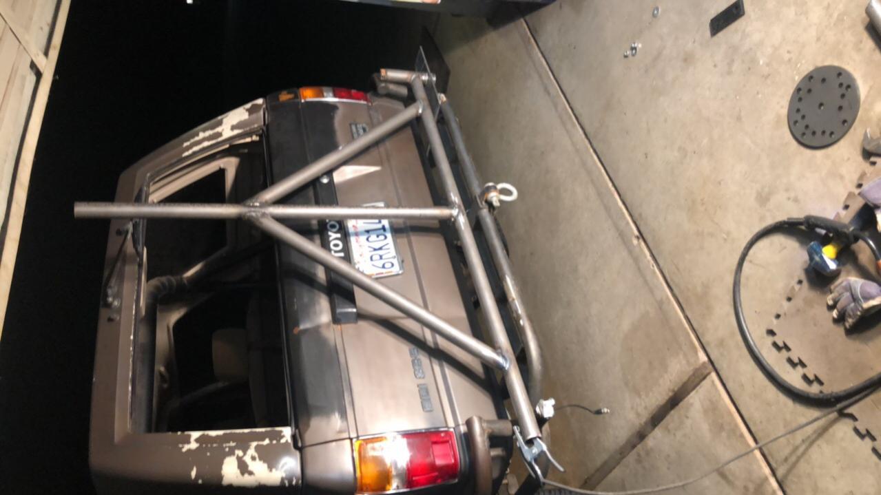

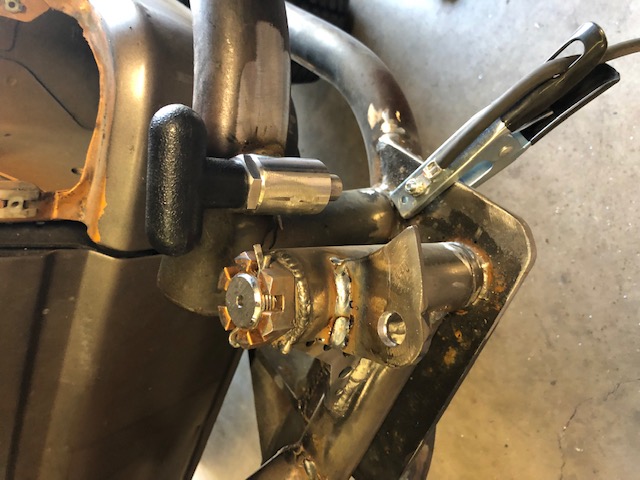

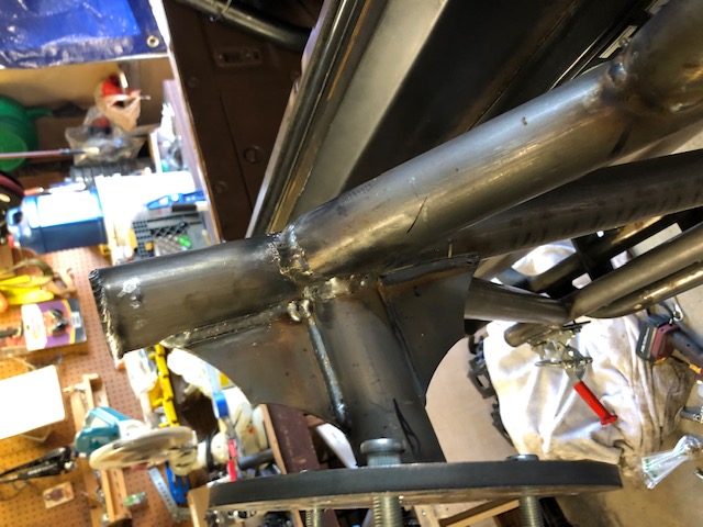

So my youngest son got everything buttoned up on his brothers tire swingout. This was his first "big" fab project and I think he did an awesome job. Now it's pulled off ready to be painted.
The bottom hinge is a trailer spindle. My son says if he were to build it differently he would have made his brother spend more money and buy a real swingout hinge with the bearings and everything, but his brother was trying to be cheap. But his big brother (the customer) is happy with it.
Ryan

Yeah, the trailer spindle is frequently used for that.
There's a backup plate for the top mount above the taillight?
Looks great!

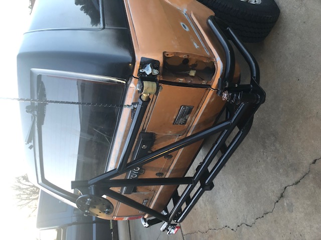

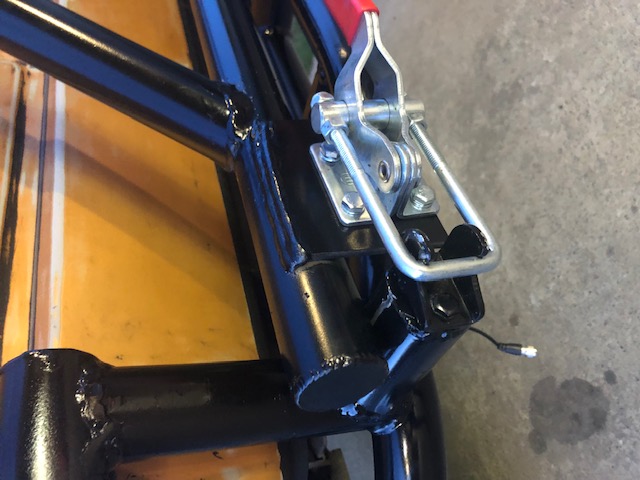

got it painted
