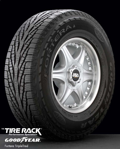

Ok, I'm about to ask a stupid question and follow it with another stupid question. First, how do I know if the tires that come up for the 4Runner on TireRack (265/65-17) are P rated?
Also, I noticed that the TripleTreds are directional tires. I started wondering, how do they rotate those tires? If I move a tire from the driver side to the passenger side, the direction on the tire will be wrong. Do they have to take the tire off the wheel and reverse it?

If the description is something like "Size: 265/70HR17 Serv. Desc: 113H" passenger tire. P tires have a Load Index, 71-115 or something.
http://www.tirerack.com/tires/tiretech/techpage.jsp?techid=35
"Size: 265/70R17 Load Rating C" LT tire. Light Truck tires have a letter.
http://www.tirerack.com/tires/tiretech/techpage.jsp?techid=55&currentpage=70
Directional tires are rotated front to rear, nothing side to side.

The LTs are "E" rated and cost more.
