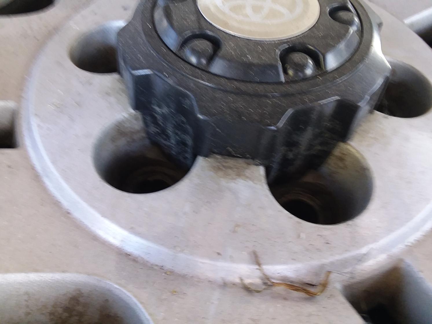

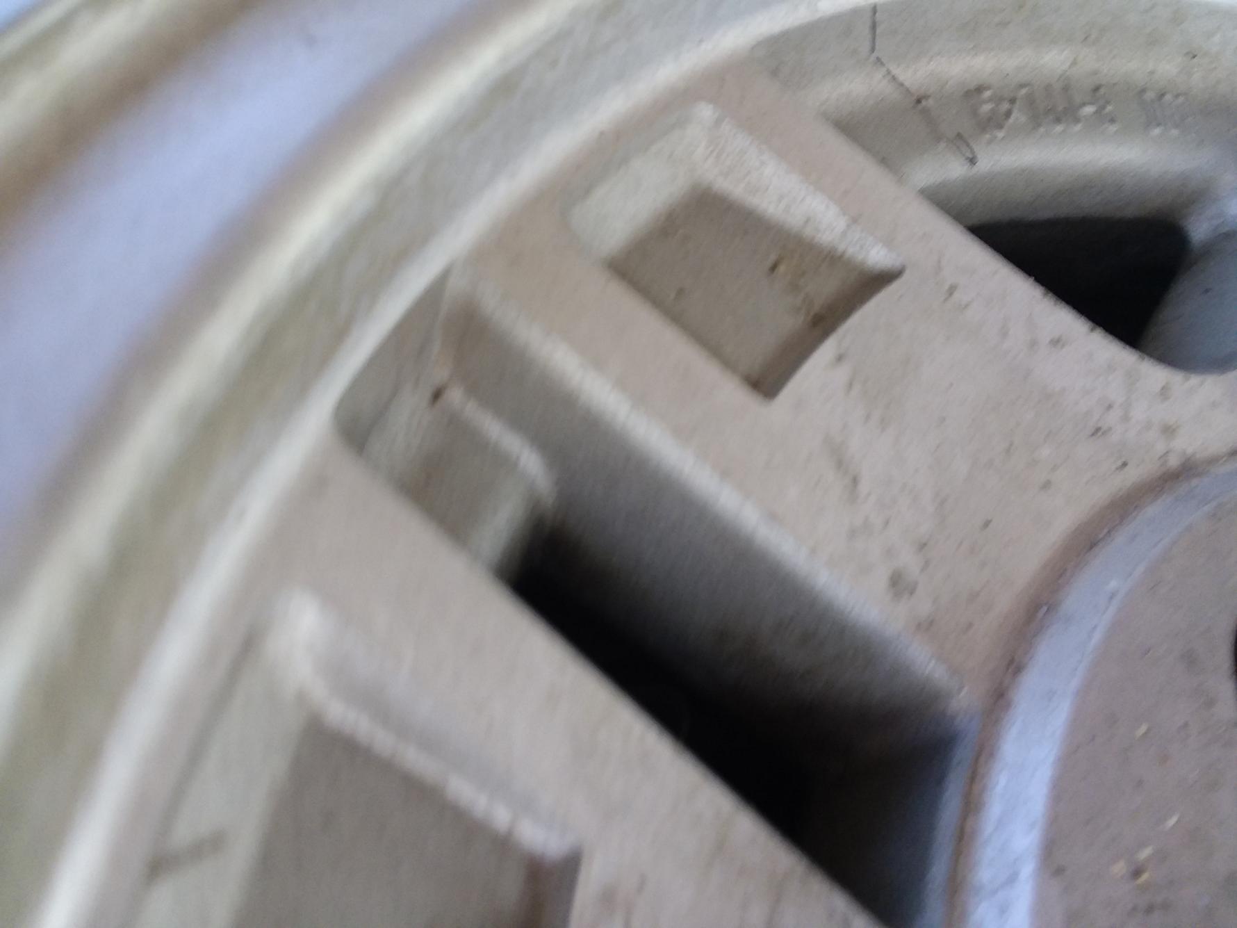

My 2000 4runner SR5 2wd came with 15 inch wheels. I just picked up a set of 1996 T100 15x7 JJ wheels (4wd version) and am gonna put them on this week, as soon as the shank lug nuts arrive to Oreilleys. Has anyone used this wheel on their 4runner?
