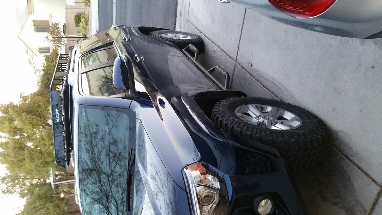

Anyone tried these
Did some reviews on AT Tires and these had one of the highest ratings, so i got it and satisfied so far after a week.
