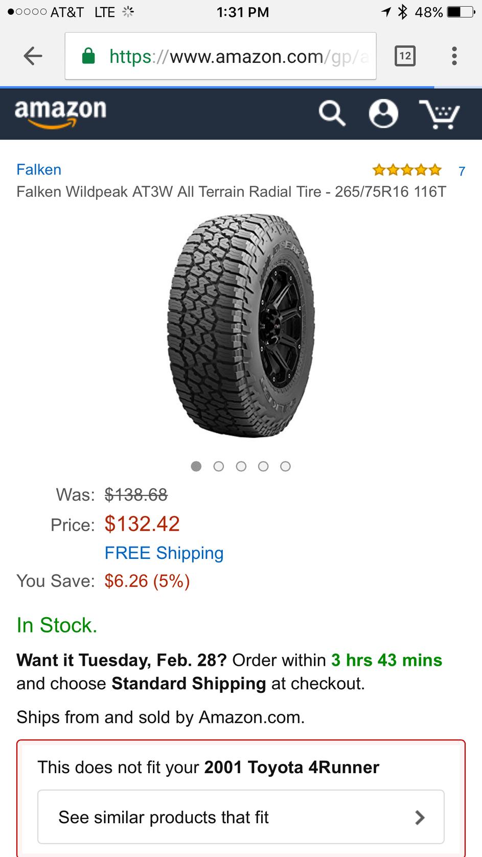

The Falken Wildpeak AT3W is a winter rated tire. It has the snowflake symbol on it and everything.
You can order them on Amazon for $138 per tire and free shipping in P265/75/16.

I got my wildpeaks from tires-easy.com great prices and fast shipping. They were at my door before 24 hours had even passed since my order.
[MENTION=3602]skywalker1020[/MENTION]
I know that. However, they are E-rated, which is not going to help the OP achieve his desired soft ride.

So the Falken wildpeak at3W in 265/75/16 comes in a LT version. Other than them having a deeper tread and weighing more, what is the pro/cons of going with a LT versus the standard 265/75/16.
