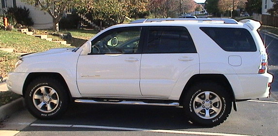

Here is mine with the BFG 265/70's, only rubs very little on a very fast u-turn...

Got the tires on and they look great. $680 installed. I think I got a pretty good deal. They do rub however. If the tires aren't straight going over speed bumps and even backing out of stalls and turning the wheel they rub. Anyone else experience this? I'm hoping once the tread goes down it will go away.
i have no rubbing at all over speed bumps, slow or fast.. only hard braking during a u-turn have i noticed a slight rub...
Looks like they may be rubbing on those plastic "upside down pyramid" shape things that are right below the bumper on either end. Right below the front turn signals. They also get VERY close to the upper A-Arms. But yeah, backing out of stalls and turning the wheel all the way to either side, I hear it rubbing.
