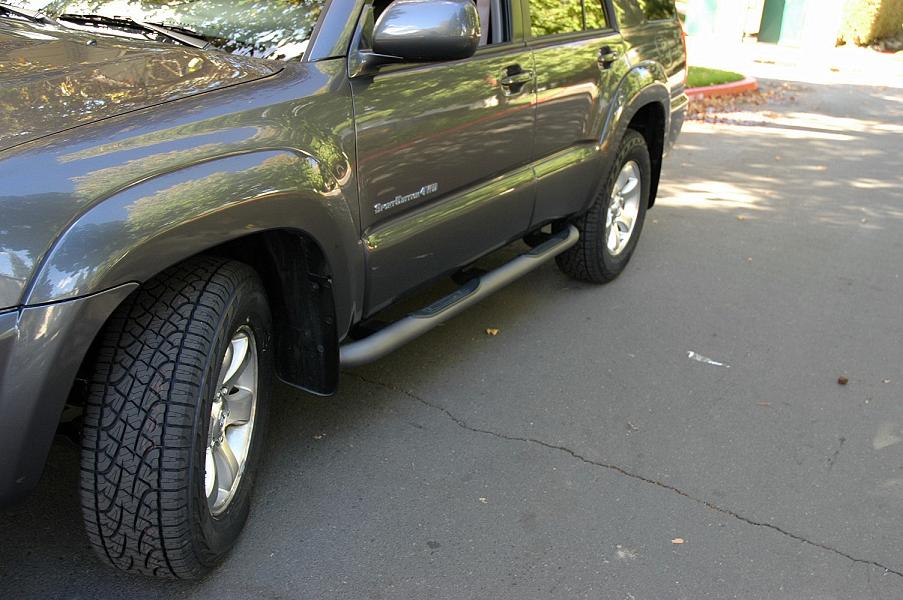

so far the tires are great. waiting for the 1st rain/snow. it's kinda like putting a racing tire on the 4Runner. tracks like a cat and adds road feel. so far so good. see the thread the Beast Likes Italian Shoes for a pic....waiting for RAIN!!

BTW, here's my preliminary take on the Scorpion ATRs compared to my old (40K miles) Dunlops:
1. They are marginally noisier than the Dunlops, but the change is barely noticeable and overall they're amazingly quiet for an AT tire.
2. There's slightly less body roll around corners, which suggests the sidewalls are stiffer than the Dunlops.
3. More bumps are picked up from the road (no surprise for a stiffer tire) but overall there is more "damping" of rough road surfaces. In other words bumps that are picked up are less jarring. Again, not a great surprise considering the Dunlops were old and the compound had probably hardened over the years.
4. Grip seems fine but I haven't really tested them. No rain here and I've only put 100 miles on them.
5. Tracking is improved from the Dunlops. There's less steering wander and steering feel has improved.
6. No problems with balancing. In fact, less weight was needed to balance the tires, overall, compared to my Dunlops and the steering is smooth as can be.
