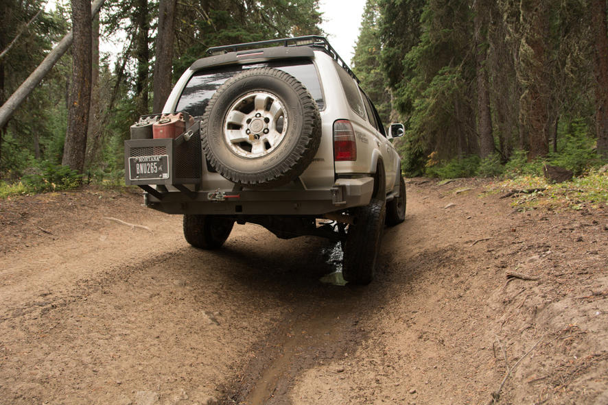

So here is the deal, I just finished my mod of the Bandit runner rear bumper by putting a rear tire swingout w/ two jerry cans. I love it but ever since I put it on I have a very unpleasant rear end wag. I noticed it first when doing 50+ and a lot on the highway doing 70-80. I recently did the Toytec BOSS coilovers with the superflex coils in the rear. I didn't notice this wobble in the rear even when I had my spare in the rear hatch and 80 pounds or so of extra weight to get the coils to settle with weight before the swingout was done.
The Wobble is usually set off by either a slight side wind or a bump in the road that effects only one side then disrupting the balance of the truck. Sometimes it goes away quickly othertimes it just keeps wagging back and forth like a dog wagging its tail.
What I am running in the rear is superflex coils with toytec boss shocks, custom extended swaybar links, and a custom panhard drop, stock everything else. All on very worn down Cooper Discoverer AT3s 265/75r16 that will be changed out soon. PSI tested anywhere from 25-40 and still happens (not as bad at 40)
So what I am wondering is if this wobble is just because of the new weight distribution in the rear and I just have to deal with it? Or is it some wore out 214xxx mile bushings in the arms going from the frame to the axle that just need to be replaced? Or something I am just not picking up on?
Also a pic of the swingout because why not? it is double hinged so that I have two swingouts for a table on each side, one for my and one for the wife. And I like the idea of less weight on each hinge so they work better for longer. Hinges by 4xinnovations.

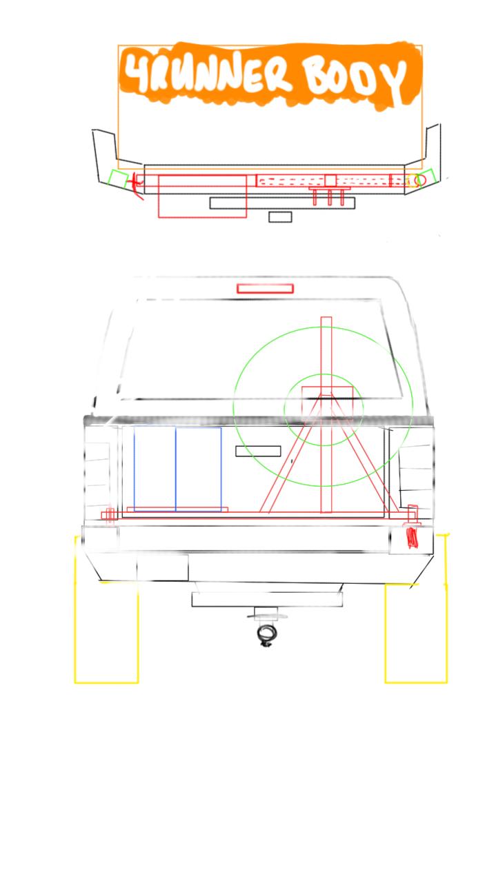

So I don't have a swing away yet, it will come hopefully in the next year(or less if I can get my dad to help me..). So anyways, I have a complete steel bumper already on the rear versus stock and I haven't noticed anything. I had similar wait during my overlanding trip and had no issues what so ever. I have almost the same exact setup as you for suspension minus the stock track and panbar.
Here is a picture
Here is what I'm going to do -

However, I just wanted to say that your bumpers and swing-outs turned out real nice! Let's see a pic of the swing-outs open and the tables set up.
