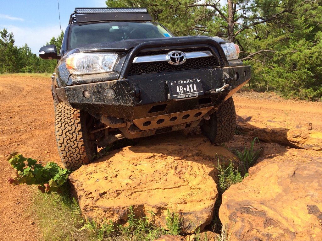

If you need front end protection save up some $$ for a bumper. I had mine custom built by a guy on the board here and I love it. The funny thing is, I think a lot of people don't even notice it, because there's no "hoop" or "stinger" on it, but that's what I wanted. I wanted front end protection, winch mounting space, a place for shackles, and improved approach angle and fender clearance (my 255/75/17 BFGs would rub on the fender liners at full lock.) The bumper is "everything I need and nothing I don't."

Is this guy building them for sale? I'm online looking for a bumper today, thanks to a careless driver trashing my front bumper. Figured I may as well apply the insurance money on a bumper that I like.

He was, but I don't know if he still is or not. He posts here under the moniker of Mtn.Runner I believe. His name is Jesse, nice kid, very young (early 20s.)
He was in the process of opening a shop in Basalt (between Glenwood Springs and Aspen) and was offering a discount to the first 3 people who would commit to buying a bumper. Don't know whatever happened to that, this was last May (2013.) Haven't heard anything more about it since. A quick search reveals that he hasn't posted anything on the boards since this past May (2014.)
The bumper is well made and has held up great. It's also made a great improvement in my approach angle and allows me to run larger tires without too much of a lift (before the bumper was on my 255/75/17's would rub on the forward portion of the inner fender liners.)
Unfortunately it doesn't look like his business ever got off the ground but I can also recommend Scotty at Addicted Off Road who just came out with a bumper for the 4th gen. I had an Addicted Off Road bumper on my 3rd gen and it was very well made. Scotty is located in Greeley, CO which makes him more convenient to the front range if that's where you are. No need to have it shipped, just pick it up in person. That will save you a few hundred bucks right there.
