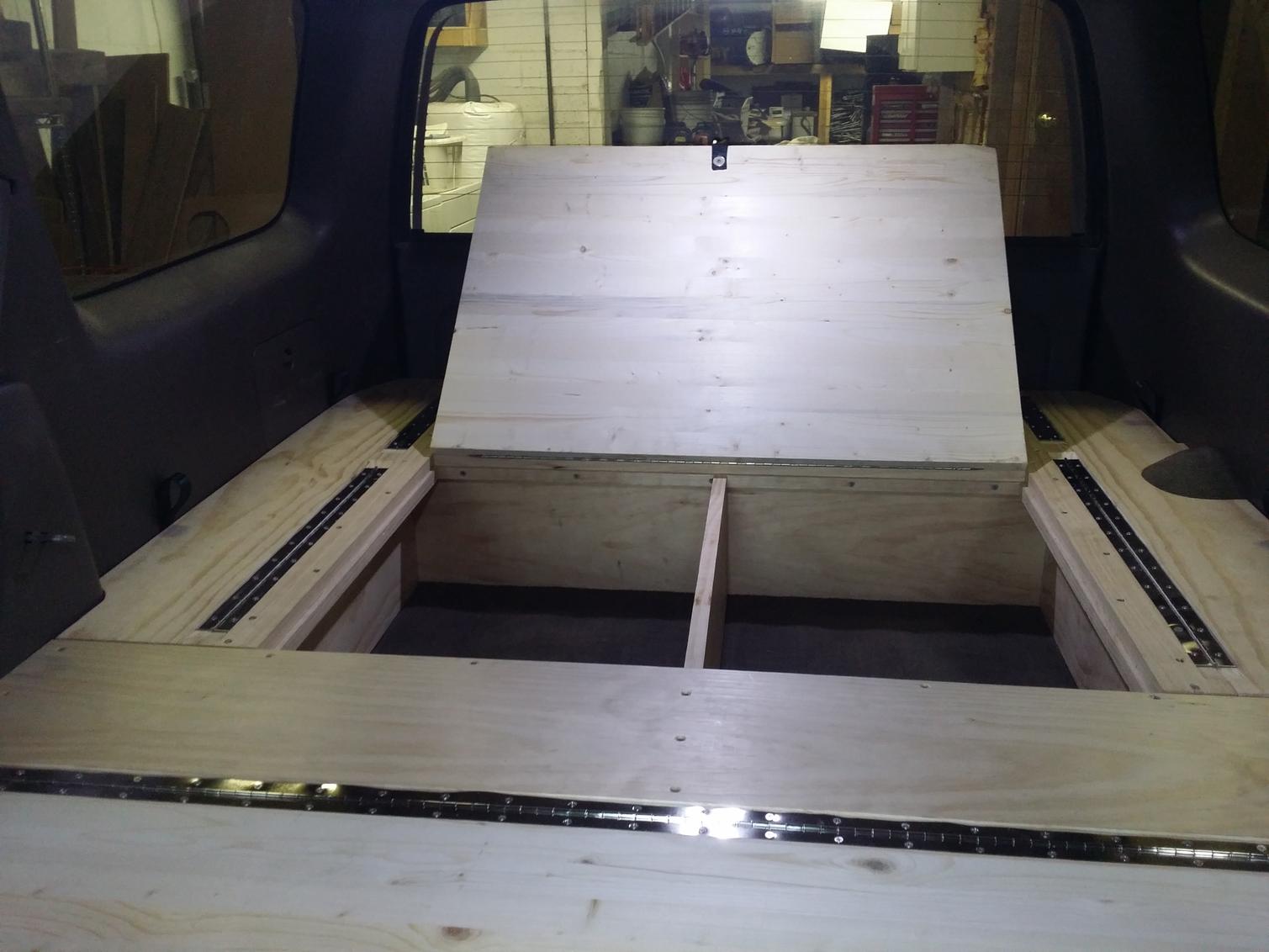

I've seen use a piano hinge that allows you to access the stuff you need. I had an idiot spotting me through and icy creek and I was in this exact situation when my rear tire slid off a boulder. Had to borrow a tree saver, shackle, and snatch block from a friend.
All of my recovery gear was totally inaccessible.

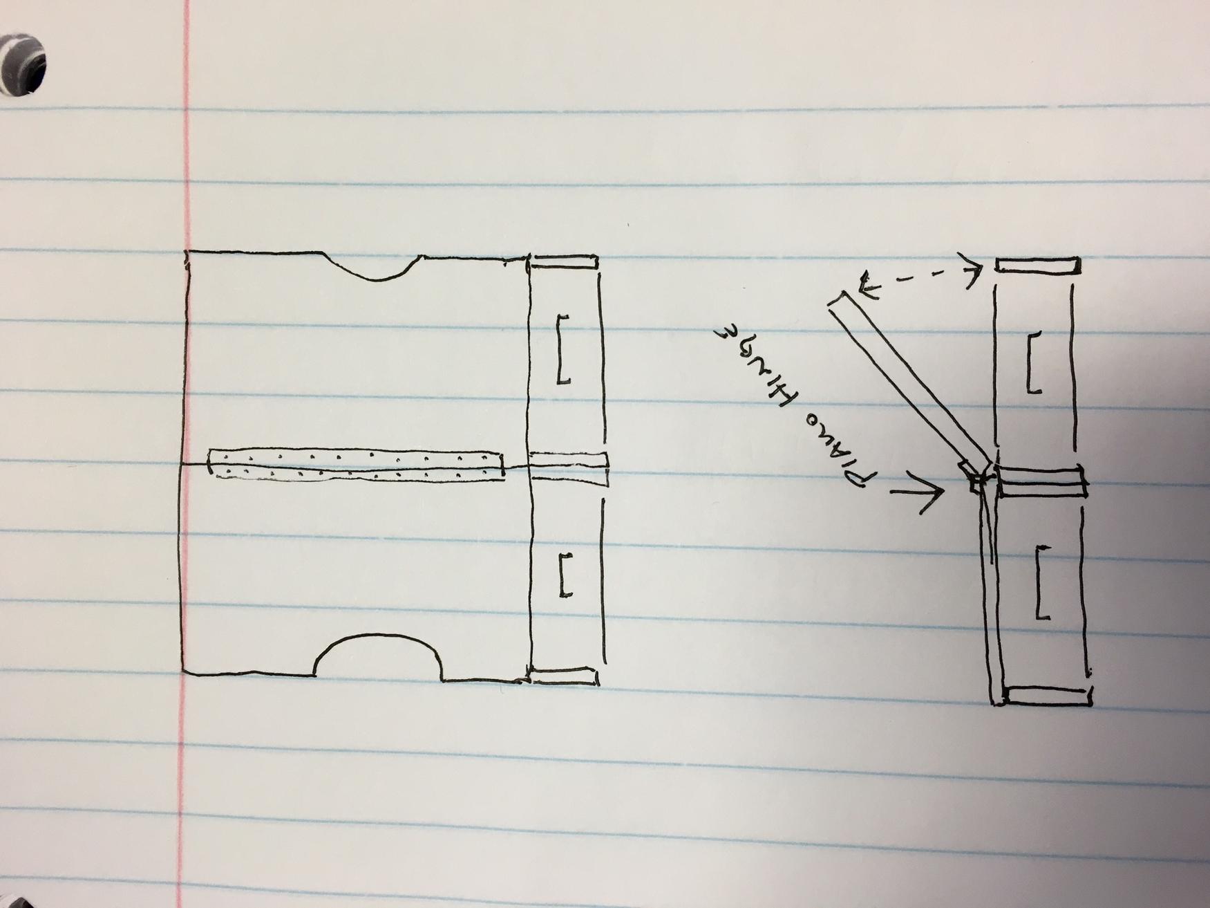

I like the hinge down the middle, but maybe you could do a top hinge on the side and a bottom hinge on the middle, then you could accordion the whole door... Be better not to have anything under, even a little piano hinge.

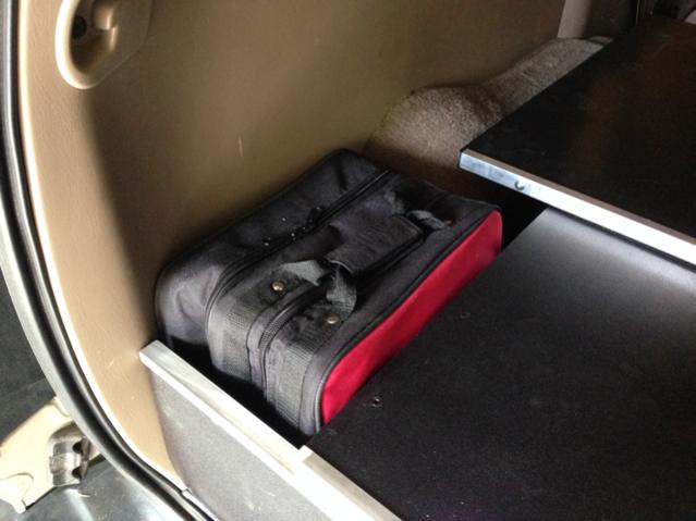

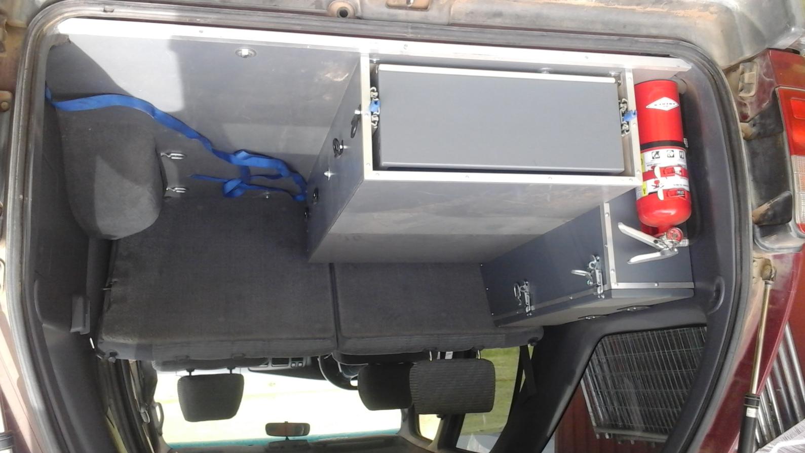

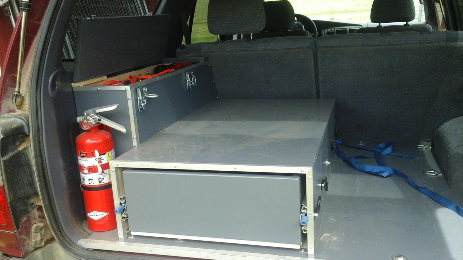

Mine is a bit different then most as I have no desire for a sleeping platform . But I did want to be able to access my recovery gear if I could not open the back hatch . All my recovery gear is in the side box .The drawer is sized for a colman stove and the open space for a fridge . 20160708_151052.jpg

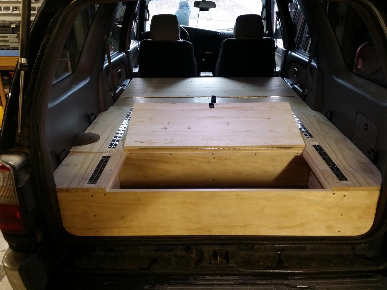

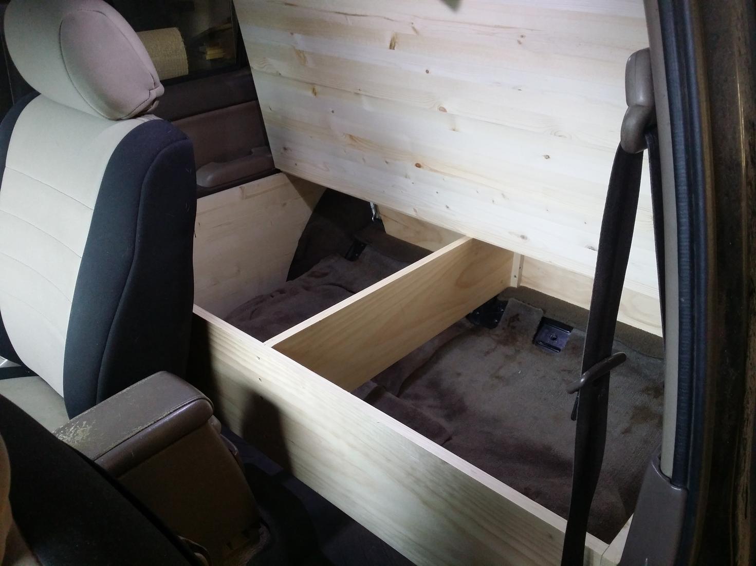

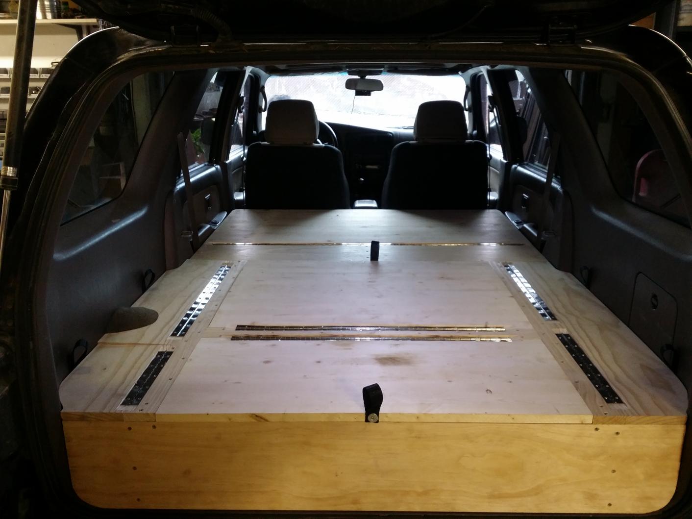

Here's mine, I didn't like the drawer idea so mine are all lids that open from the top. They can all be opened from the inside although it's not easy when the sleeping pad is in there lol. Doesn't seem like what you are going for because I have no drawers at all but it might give you ideas.
