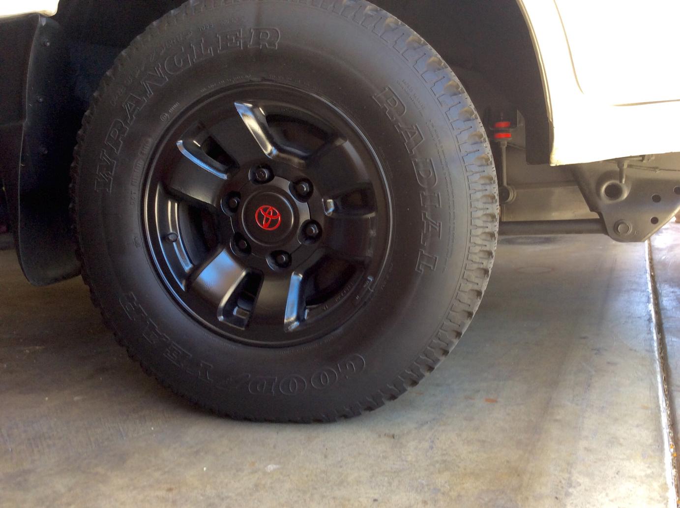

Here is a pic of my rims black which is the same as yours..hopefully this will help

Sorry guys... I didnt see the questions ..but i used my chicks high gloss nail polished then clear coat. Works perfect hardens like a rock and wont fade.
Looks great man! I'm considering this too!
That's a pretty original design on the emblem on your grill there. I like that!
Did you paint them or plastidip them and how much was the cost? Did you sand them down? My rims have a decent amount of aluminum corrosion and buildup.
I just plastidipped everything. Emblem I covered specific parts with painters tape. 4 cans of plastidip for 5.99 each at home depot. Before you spray wheels clean with dish detergent then windex. After that spray one coat.. wait about 30 mins if it's nice out, put another on, I did 4 coats each keeping a uniform pattern. Total was 28.00 for it all. I left lug nuts unspayed to give it a nice finish look.
