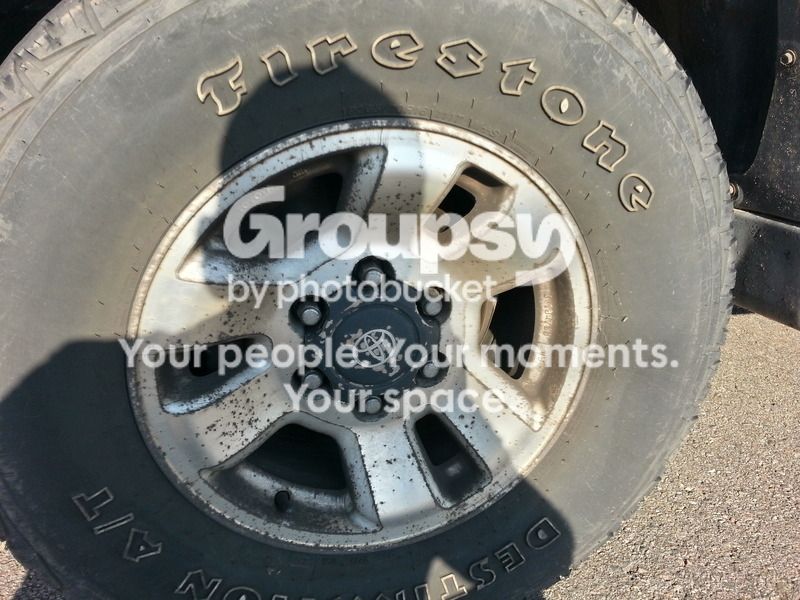

To Plasti Dip or not
I've done that. I use my originals to mount my winter tires and the finish was crap.
I cleaned the wheels and sprayed them with plasti-Dip. A year and a half after a Canadian winter, gravel, salt and all, they still look good.
In fact, I plasti-Dipped my grill 3 years ago and it is still holding up.
Try it out. If you dont like it then peal it off. Just make sure you put it on thick enough. A can per wheel is a good rule of thumb.
Yeah if you don't put it on thick enough its a real pain in the a$$ to peel off. Like others have said, it holds up pretty well and it can be temporary if you want
Going to give it a try. nothing to loose. Just take off if I don't like it.
Thanks for the input.
Definitely do it. Worth it for sure. And yes, it lasts quite a long time. Thickness is the key, spray atleast 5-6 coats per wheel. I used 3 cans to do all 4 wheels.
