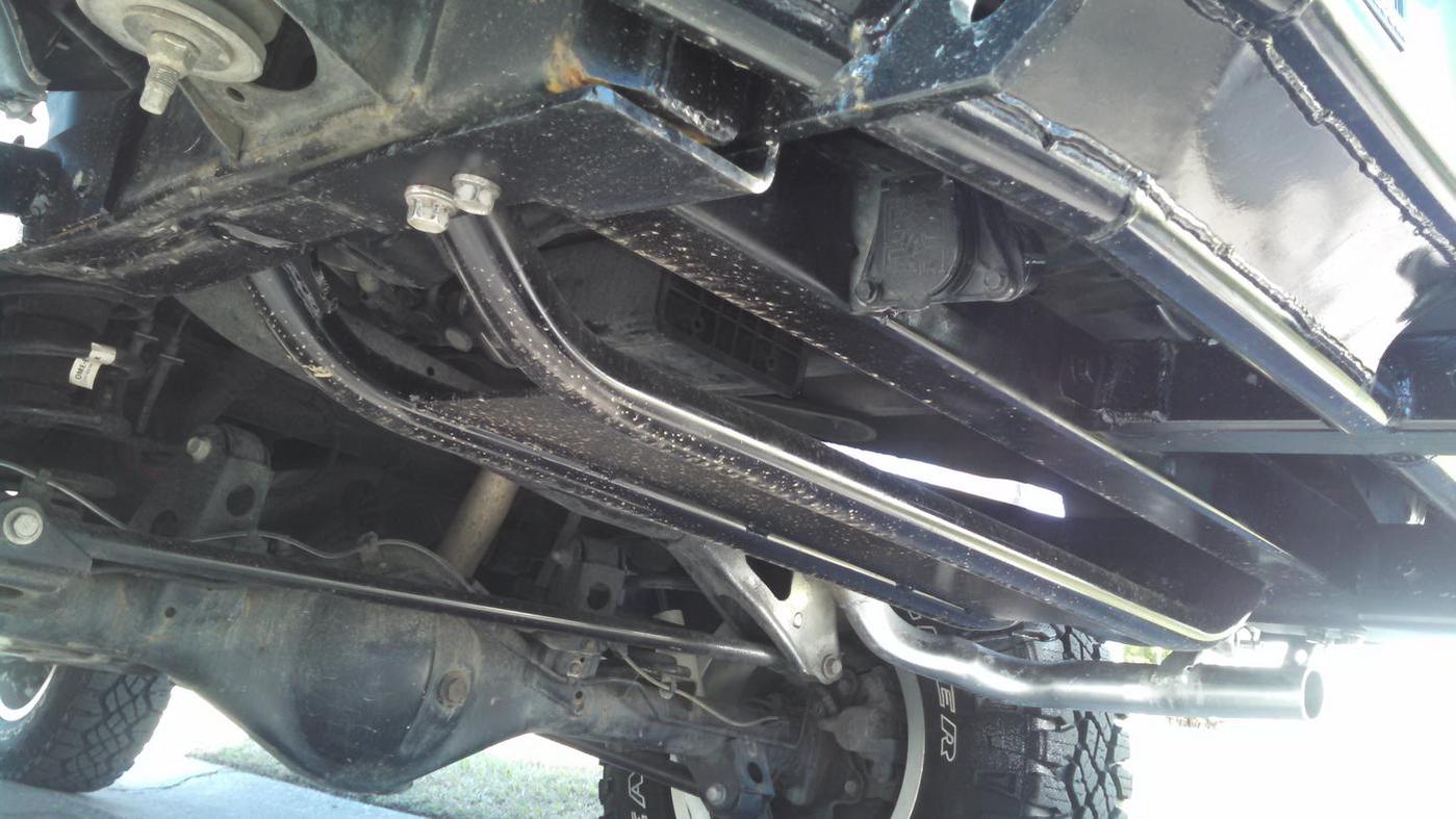

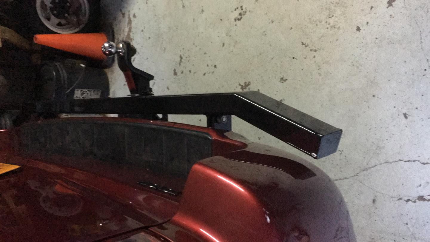

Save the money. Build something simple if you can weld thats what am doing. Its still not finished. Just taking my time not in a rush to build it. Got the idea of a iser on the 120 forum.
I had mine cut out on a plasma table at work and welded it together in a weekend. The latch and the spindle is welded directly to the rear crossmember. You could easily incorporate a rotopax mount or something similiar. More pics in my build thread with a how-to.

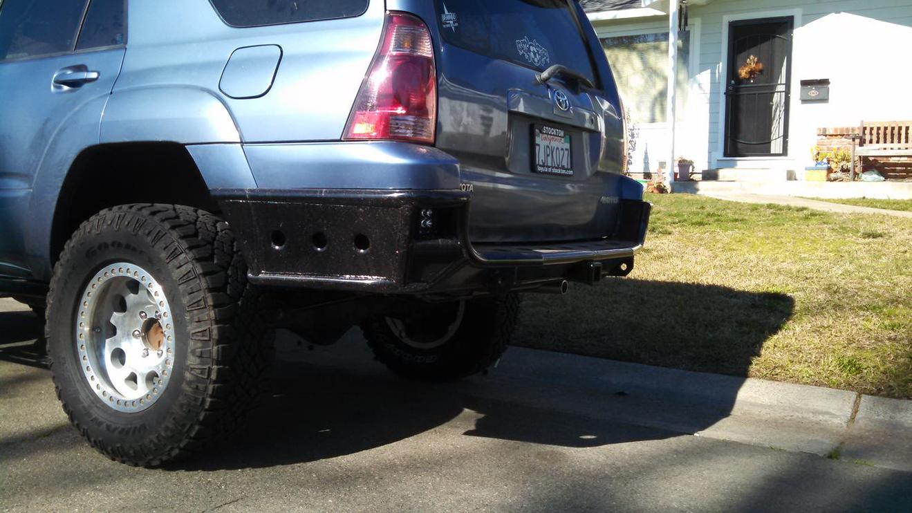

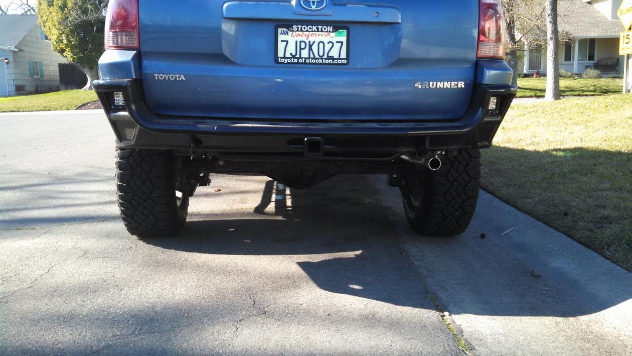

There wasn't anything I liked, so I had one made. It is stronger and lighter than any of the plate versions, just really difficult to build. If you can find a good fabricator in your area he could probably do something like I had done. Or you could call the guy at HMF and see what he will do.
Hot metal fab
