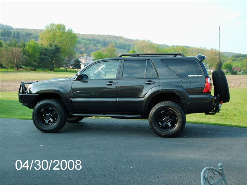

I did not trim anything and I am running the Firestone A/T in 8ply becuause I got 5 for 900 out the door at a local shop. Here is a picture.
Damn! That is one mean looking 4R!! Looks awesome!! ARB front? I guess by removing the front bumper for a steel aftermarket you wouldn't need to trim the lower corner- and besides that you just took off the mudflaps huh? By the way ...what kind of rear tire carrier is that ?

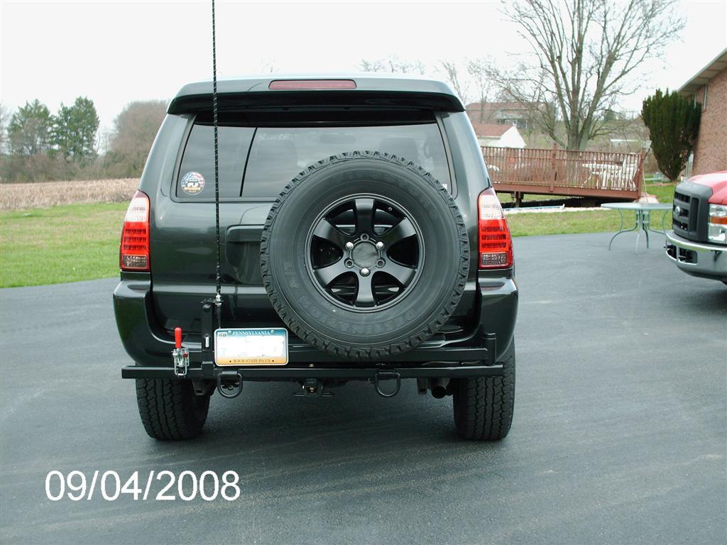

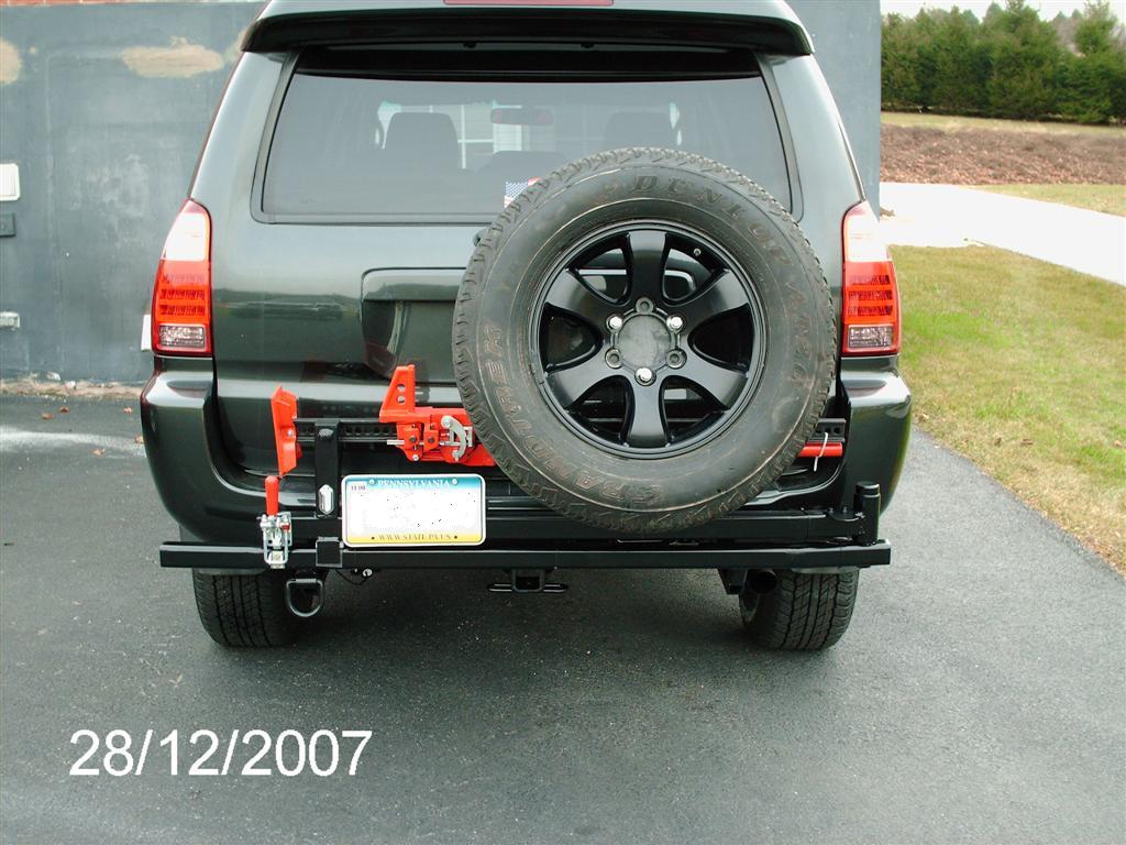

Oh yea sorry I did remove the front mud flaps and trimmed the rear. The tire carrier is mine I built it to do what I needed it to do. Here are a couple pic of the carrier. If you can weld I will send you the steel to make your own. I just dont have the time for atleast 3 months to make any more.

Wolf said:

Yeah! it's nice. I weld and was recently planning some over bumpers/brush guards and started thinking about maybe getting a full size spare on a carrier. would love to see more photos of yours- clean simple design- looks very efficient- I like it!!
