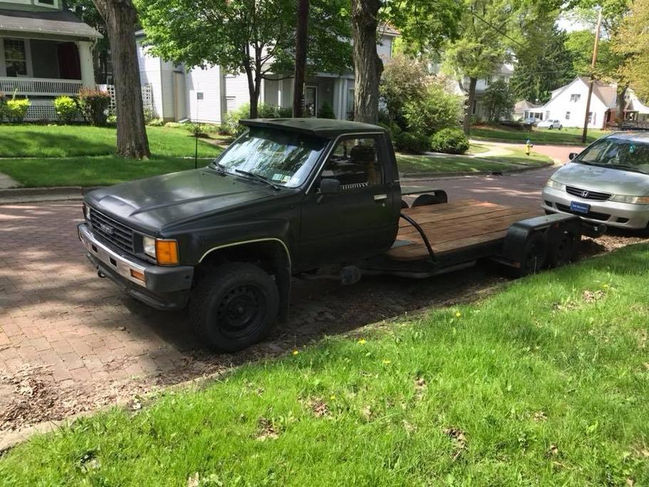

but, some dude on facebook grafted a tandem axle TRAILER onto the rear of his truck, and got it licensed. it still has the t-case, and is now a FWD car hauler. pretty cool.
not really the same situation, since our rigs would still have a rear diff in play, even if its not powered.
got a picture?
