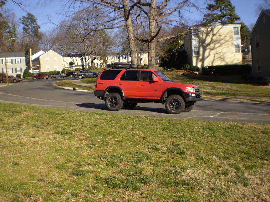

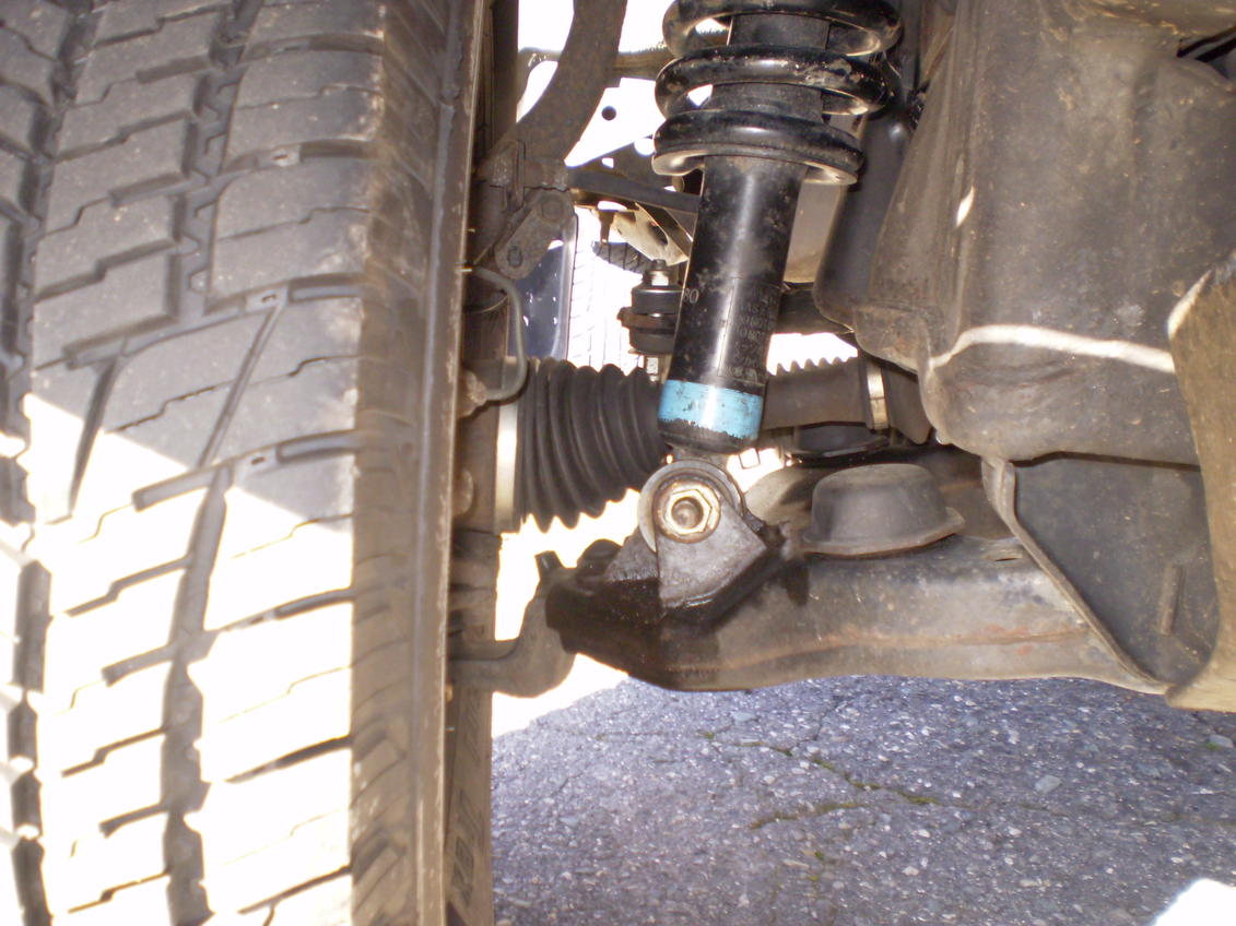

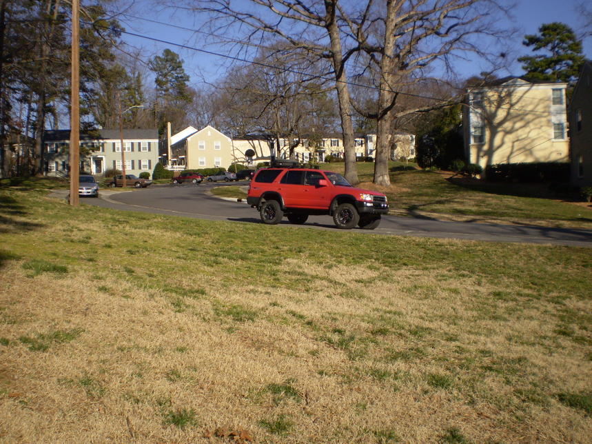

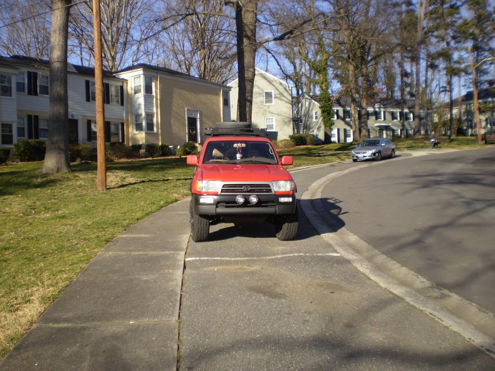

Done!!!!!!
It was a *****! lol I'm no good at this stuff. But my under carriage is rusty and those damn bolts needed a talk'n too! But here is some pic's! Thanks to Brian for hooking me up with the parts and plans!

Awesome! Looks good. Do a diff drop if you haven't cuz your CVs will probably start leaking grease without it. Glad you got it on!
looks good dude, and ya def get the diff drop for ur runner... not u just need larger tires 265/75/16s perhaps? i dont think ull clear 285s with the 2.5" spacer but i could be wrong; im sure brian knows.

haha, yeah I was able to clear 285s with that lift. Just a very tiny bit of rubbing on the front, but you will almost positively need to get wheel spacers for the front so you don't rub on the upper control arms. The spacers are dirt cheap from here if you decide you want to go to 285/75R16 (33x11s):

Respectfully, that's not right. A diff drop won't have any effect on alignment. But you still should do it ASAP, my CVs started throwing grease within hours.
With IFS, the diff sorta "floats" under the engine and above the skid plate. It's only bolted in the front with 2 arms that come out (this is where you stick the spacers for the diff drop) The rest of it is kind of suspended by the CVs and the driveshaft. You just take the skid off, take out the 2 bolts, slide the spacers in and the longer bolts, tighten back up and replace the skid. That's it.
Nathan, don't let it trip you out when you go to install the diff drop and it looks like there's not enough room to drop the diff without hitting the frame. The diff only "drops" in the front and the rest just rotates. I looks kind of ineffective when you put it on, but it helped my CVs out a lot actually.
