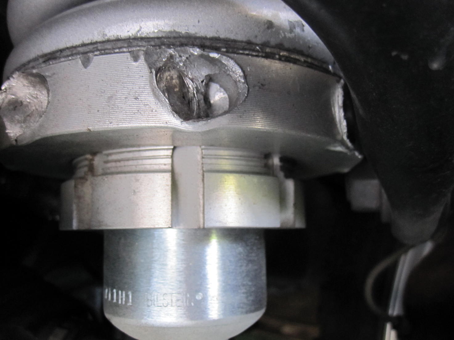

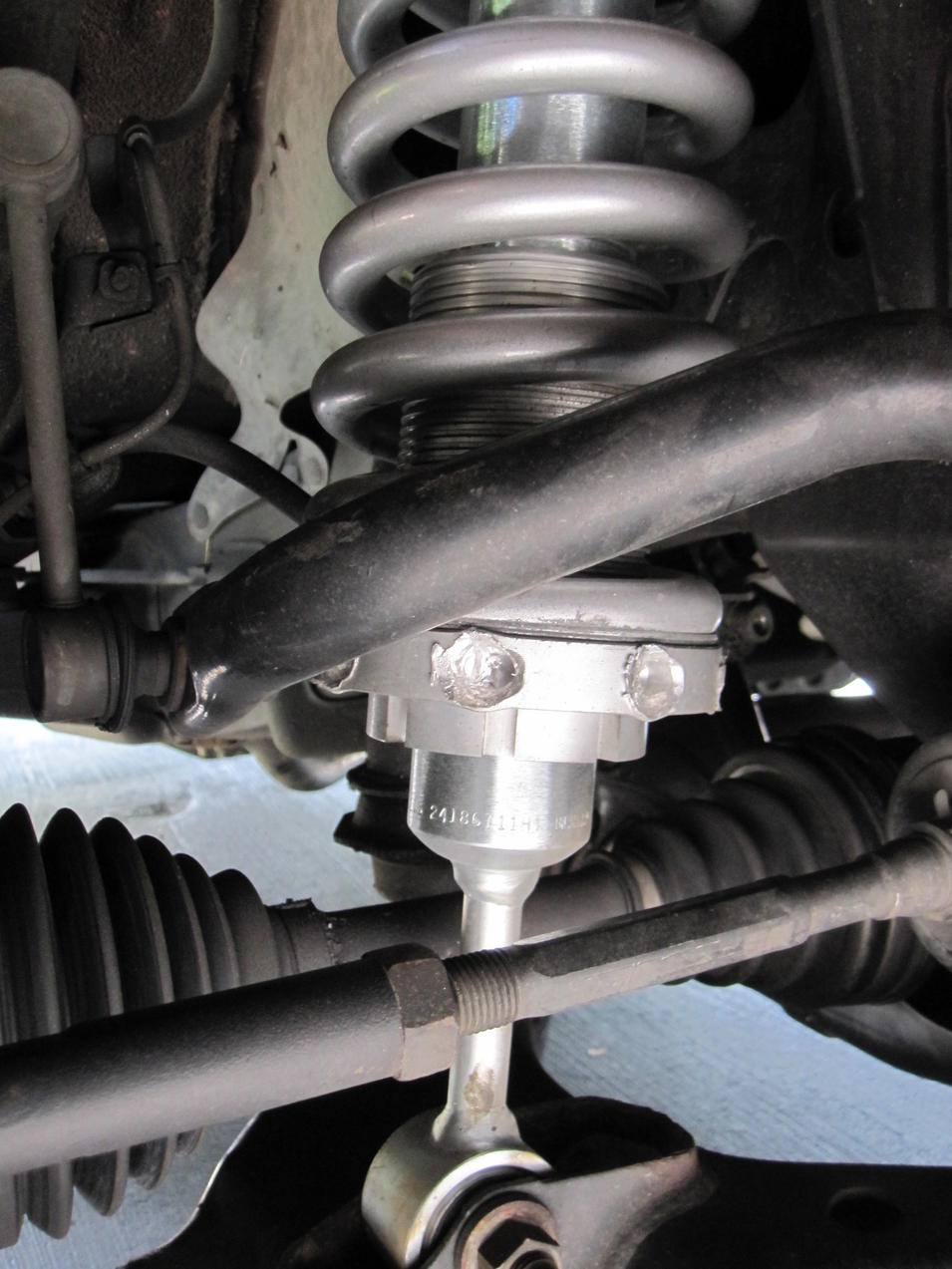

I agree with you all.....and come to find out, our friends at XYZ lift company did NOT have it lifted UP.....they lifted it DOWN. Note the damage on the ring. They also had the wrenches to turn the ring UP so that I would get max ride height. MAN....it's hard to get good help!!!!

I can't believe how bad they screwed that up, and they gave it back to you with no word of what they did? what *******s, I'd make them buy me new ones, and pay another shop to install them, that is crazy, best of luck to you with everything. sometimes the extra hassle and work of doing it yourself is worth it.
Wow...that's bad! I would also recommend taking it back ASAP. Get those removed and get some replacements. That should have never happened. If they have any integrity or wish to preserve their reputation they will pay for the parts, removal and re-installation. I feel hacked just looking at it...and it's not even my truck. Good luck!
As people have already stated, do not put spacers on top of coil overs.

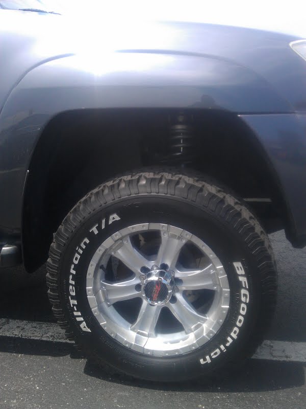

Yep....spoke to Ben and he got me all squared away! Thank you....here is the updated Pic with the proper lift height....still in negotiations about the damage.

It looks good! What wheels are those? I really like them.
I would make them at least buy new adjusting rings for the co's if not the whole co. I can almost bet they where trying to adjust them with the vehicle weight on them.
