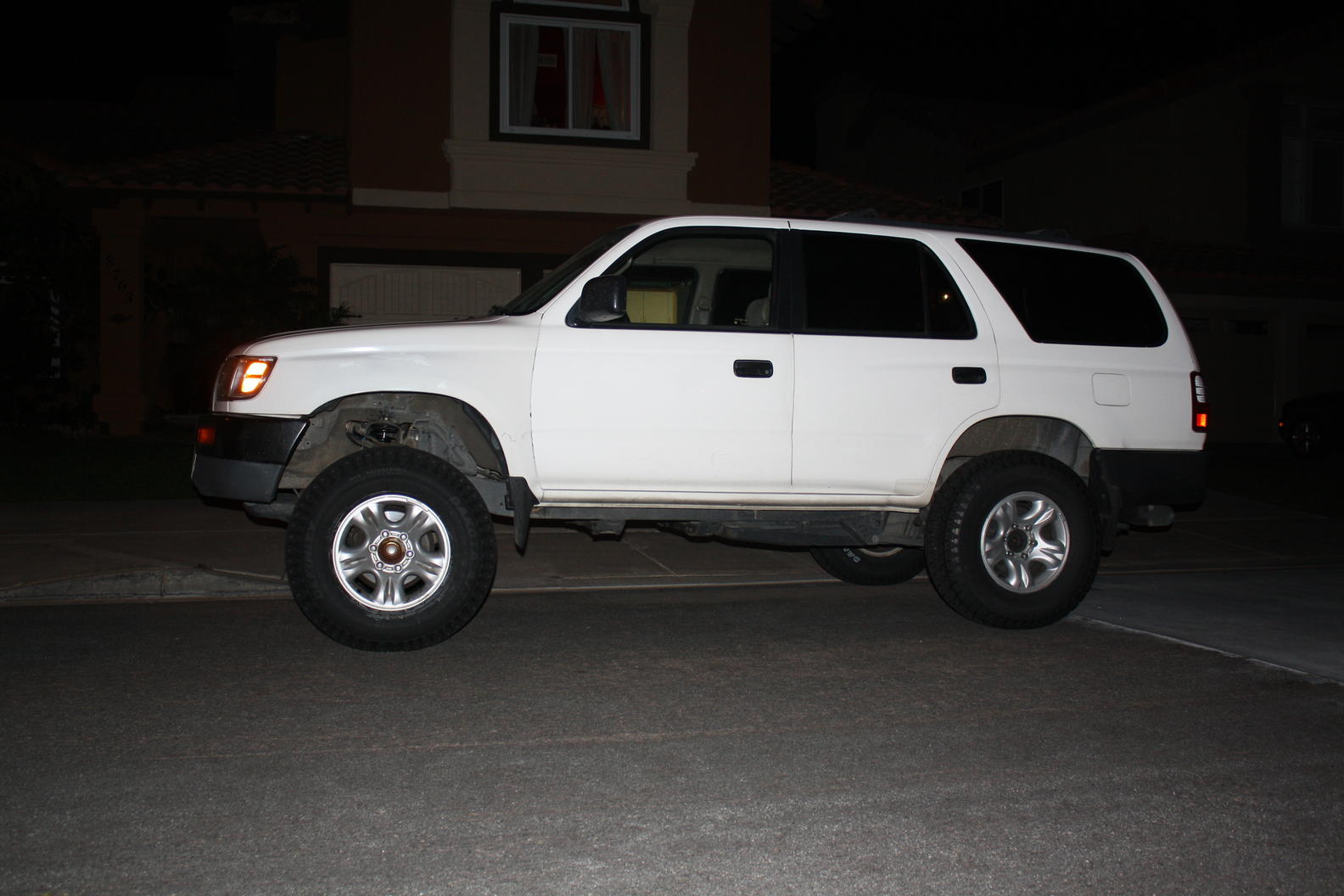

got 99 tall coils installed and i believe the shop adjusted my shocks up as well in the front because it measures from the ground to fender 39"!
i guess its not a bad thing just wasnt expecting it.. now i need coils in the back quick!
what should i put in the back?

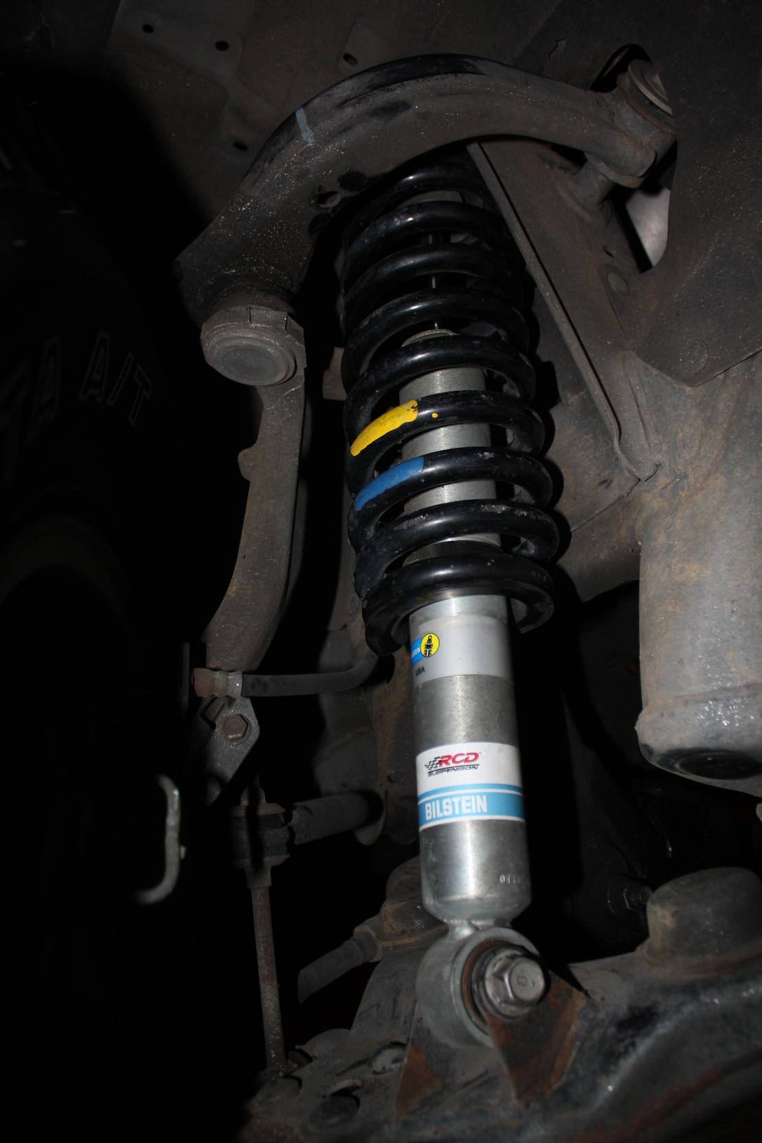

He's got Bilstein adjustable 5100 shocks up front. The Tacoma ones I believe, part number D-558....
yeah i have the adjustabel bilsteins.. i believe they were moved up to the 1.25" mark which just acts as a 1.25" spacer.
for people wanting this much lift this might be an option.. im on 32" tires so if i level out the back it just wont look to great so im just going to have the shock moved down to stock height

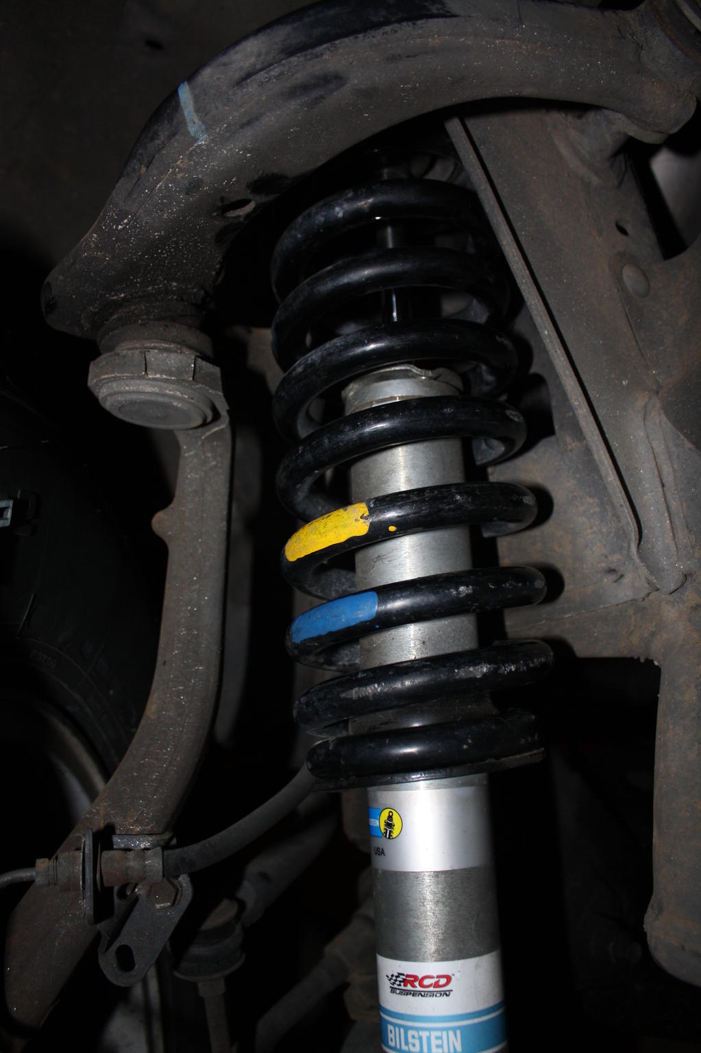

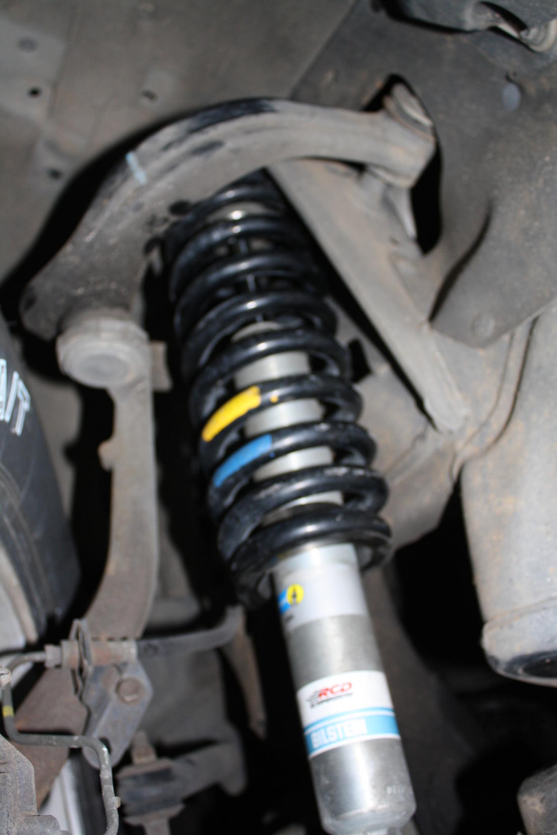

heres the shock and coil

Those 5100's aren't on the highest setting. I can see one adjustment line so those are set atleast to the second height setting. I just received a pair of 5100's from toytec and they came pre-set to the highest setting so it's possible who ever installed the shocks may have used the setting that came out of the box
Looks good to me. I just wanted to make sure that the spring seat wasn't installed upside down like COB said. I have had alot of people call me saying that they got too much lift and that was the cause of it.
i took it back to the shop yesterday and had them move the shock down and now its perfect! im sitting at about 38 but that should settle a little. its a little higher in the front still but eventually ill get 906 coils in the back or maybe just 2 trim packers on each side in the back
ill post some pics later today
I was going to say 39" is too much. i have a 1" bl and SAW adjustable coilovers on 285's and the top of the front wheel well is just over 39".
I WAS thinking it mush have drove pretty bad on bumps, as most of your down travel was taken up with lift
