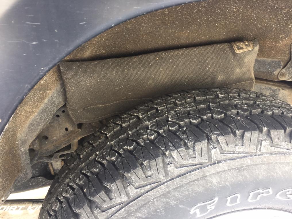

I cover up the rear shocks with shockwraps, and I had some other shockwraps modified to cover the reservoirs. Iv'e got two sets of shocks, and my winter ones go on while the summer ones kick around the workbench. I've had lots of success winterizing my winter kings... but I'm sure it looks absurd to anyone that doesn't live in this climate.

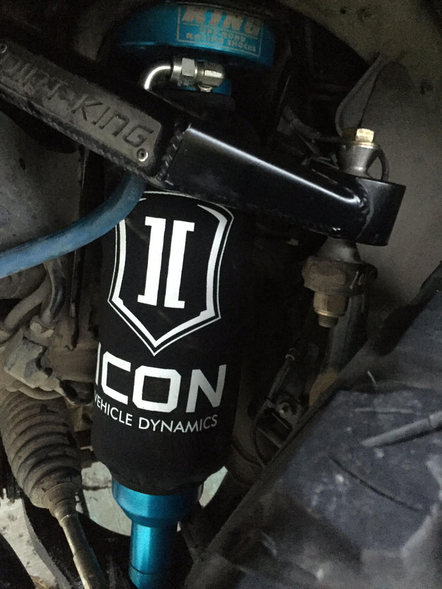

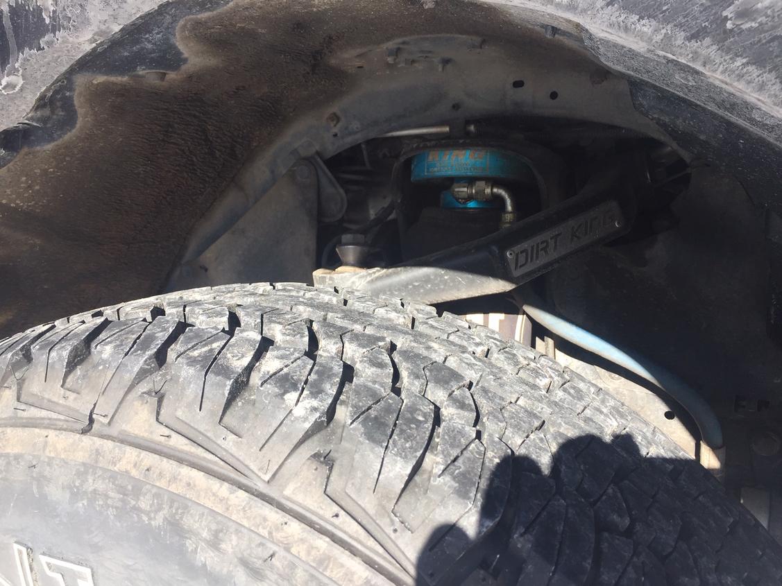

On the coilovers, I've been using icon's coilover wraps to keep the salty slush off my coils and shock shaft. They shockwraps work very well. I use boots on my rear shock shafts, as salt and sand can make a nasty pitted mess. I have the boots stretched down to also cover the lower uniballs-- this works surprisingly well.
For the fittings and threads on the coilovers, I oil them often with boeshield after my frequent trips to the heated washbays. The uniballs on my UCAs are oiled with triflo, and they're washed very often and I use compressed air to dry everything off quickly in the wash bays.
