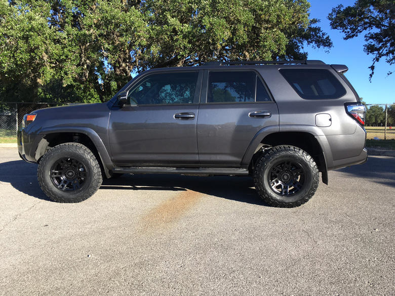

I posted opinion before, but I like photos when I am looking at info so I'll contribute. These are C load, wife's truck and 90% on road. The last week in the LBL they worked nice. Look great also.

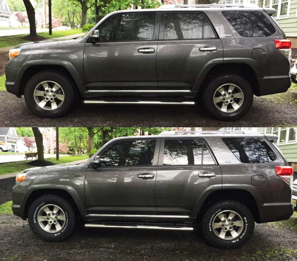

I ended up going with BFG KO2 in 265/70/17-C. In addition to a 2" front lift (ToyTec Ultimate coilovers + Bilstein 5100s) and 1.5" rear lift (Wheeler's T13 + OME 10mm trim packer on driver's side + Bilstein 5100s). I really like the 265s and happy I went this direction. I took a 0.4 MPG hit on a 2.5 hour road trip. My guess is that the 275s would have been more (but I only have 1 data point so the statistical analysis really isn't up to my usual standards).
