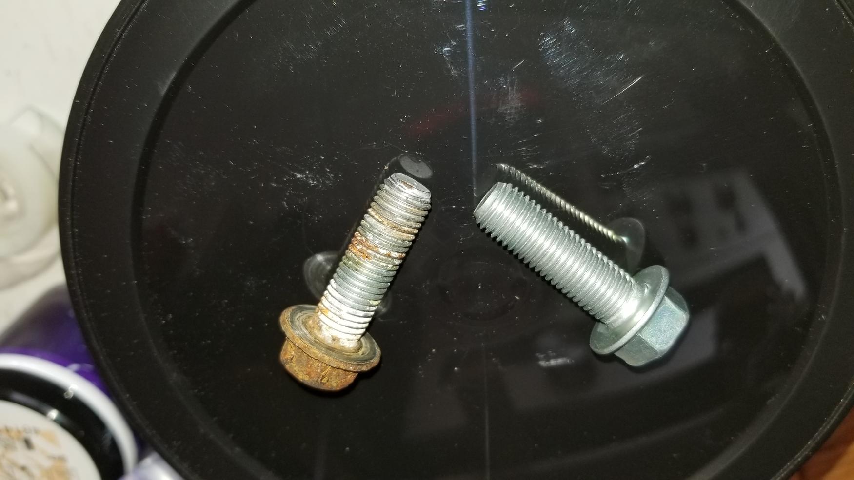

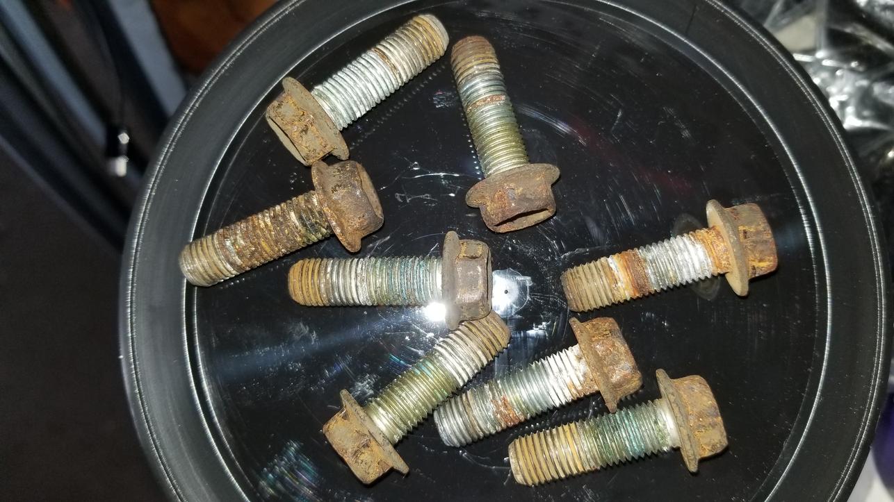

I was skeptical about replacing the 4 bolts. A couple looked pretty rusted so maybe it is worth $13 for peace of mind. FYI, this is a Virginia car, no or very little salt.
