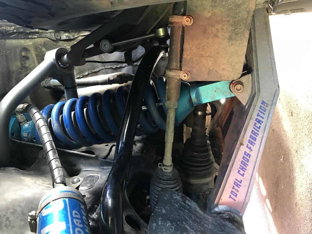

Just picked up a new sway bar from TC yesterday, give me a little time and I’ll get some feedback to post up on here. 2014 4Runner, TC +2” race kit with triple bypass, also the truck in the OP

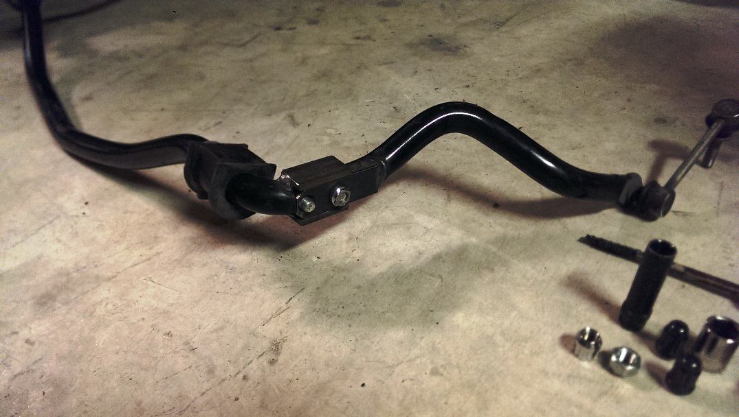

That is fantastic... Now just to make it single side disconnect like my factory one. I've had my front LT sitting in a box for almost a year now trying to decide if I can live without a front sway bar on the road.
I currently have a single side disconnect system that I fabricated. It allows one arm to be removed in about 2 minutes resulting in no swaybar. It's sort of the best of both worlds and I'm so hooked on it... it is hard to give up. Drives great on the road and even better off with the arm removed.
Can you please post a picture of it so I can see what would be involved in modifying it to be a disconnect.
Considering the new one mounts in the stock location and uses the stock links, I would think your current disconnect setup is transferable.
Looks pretty stock. I would not be able to transfer it over directly as it involves cutting the swaybar and fabricating a mechanical connection. But it could be done again. It's a very involved process though.
I don't have a picture handy of the latest rev of it, but can take one later to explain how it works. There are wheel studs and lug nuts that hold it together that are removed remove the one arm to eliminate the sway bar interference.
This is an old pic of the original rev.
156722d1431058048-im-getting-front-swaybar-disconnect-system-built-i-need-donor-bar-sway.jpg
