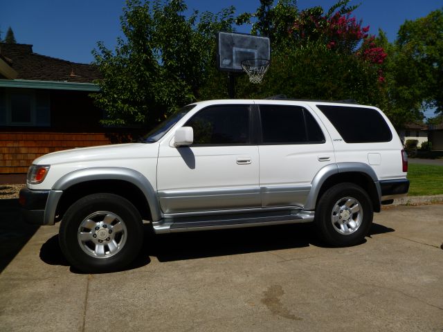

Finally - a photo of my 4Runner
I took this picture today so that you can see the height of the truck and how even it is front to back. After staying up again late last night reading and linking to various Google searches, and looking at online parts stores, I pulled the trigger and ordered Bilstein 4600s front and back from Shockwarehouse for $309.88. I am now thinking about buying 99 fronts and OME 906 rears to go with those pretty new Bils. What do you think those combinations would do to the height of the front and back???
