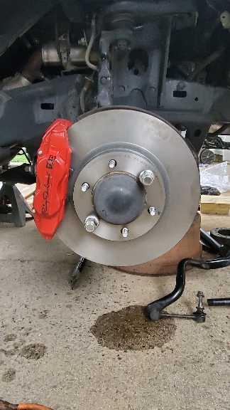

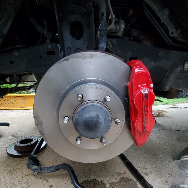

While doing the lift today/tomorrow I decided that I will also replace my brakes, decided to upgrade to the larger rotor up front since the price difference was minimal in my eyes.
I have Brembo rotors and pads for all 4 corners that will be going on. I've had good experience with the brembo brand in the past, we'll see how these do and hold up.

Literally just put the larger 338mm front rotos and calipers on. The caliper was an aftermarket replacement for the Toyota. Not tge z36.
The rotors and pads were brembo. The only "modification" we did to the shield was bend it back a little around where it was close. No trimming, no rubbing, quick and easy install.
