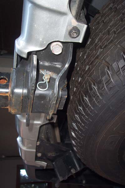

Ok, I have the old "5,000 pound capacity" receiver on my 03' and I was looking at how it is setup vs. the new "7,000 pound capacity" receiver. I am not sure I understand why the new one gives you an extra 2,000 pounds???? The one I have is a receiver mounted to a cross member, which is mounted to the frame. The newer one is all one piece that is mounted to the frame. Seems all the weight is still being carried in the same place on the vehicle for a standard tow set up (without stabilizers or weight distribution rigs). Can anyone explain the difference between the two receivers on the 2003 4Runners?
The mount location
I believe that the 5000 lb capacity receiver is mounted ONLY to the center of the truch rear crossmember.
The 7000 lb capacity receiver is a much larger unit, and distributes the weight to the truck side frames directly as well.
I think the rear crossmember can only handle 5000 lbs. I looked under mine and it is a small hitch. It looks like two bolts to the crossmember and that's it.

rensho said:
4 bolts actually. 2 are behind the bumper cover going towards the front.
I have a banged up knee this past week and couldn't get under to take a good picture:) . I had to hold the camera upside down and took a few before settling on one.
