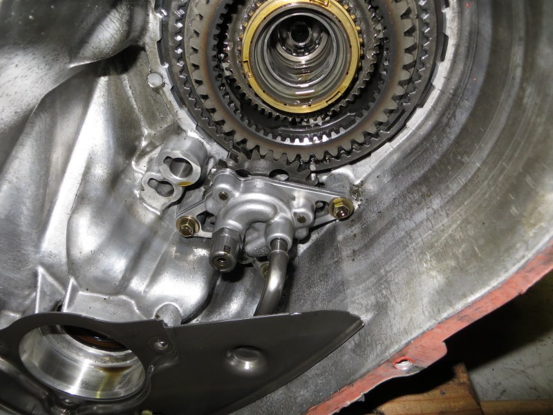

Put transfer case in neutral and tow it. No, don't do that. Here's why:
170322d1440475572-anyone-have-vf2a-t-case-internals-pics-gear-wear-img_7565_800x600-jpg
Horrible advice!! 4runner transfer case oil pumps are driven by the input shaft and with it in neutral you might bounce enough fluid around to lubricate everything but you might also destroy the transfer case.
