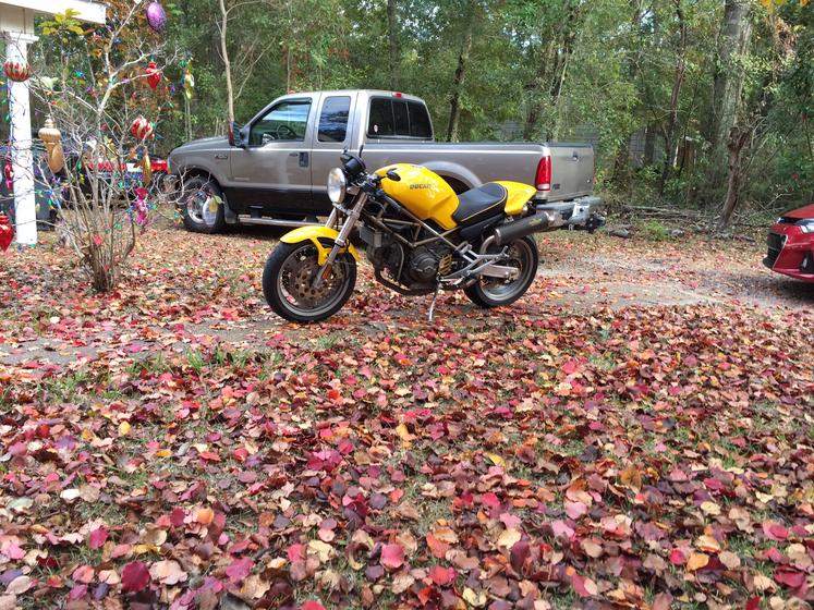

Used to have a '98 M900 that was yellow... Miss that thing really bad :(

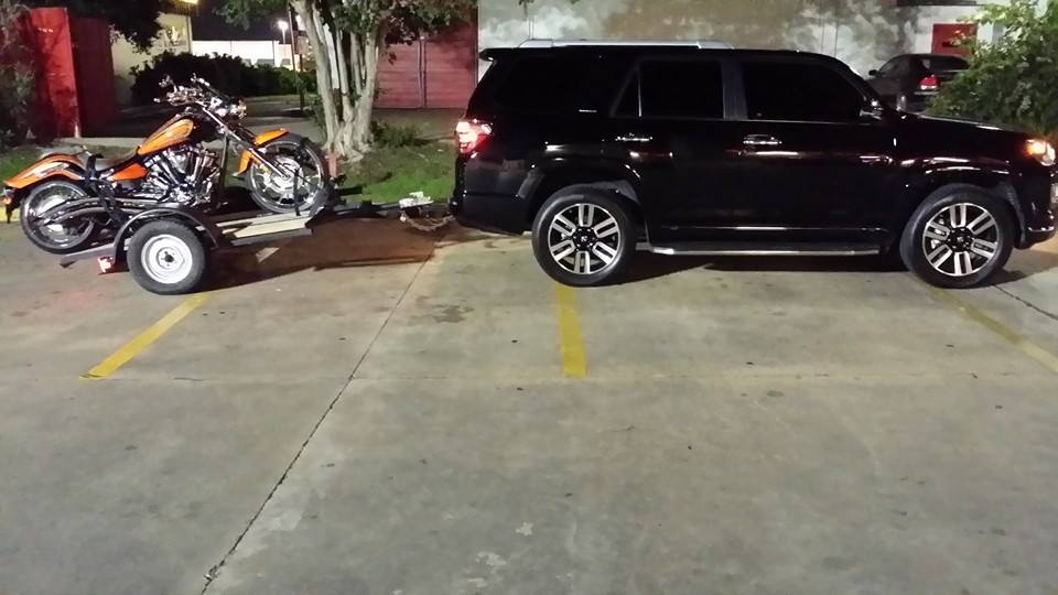

Miguelon,
You have a very nice looking setup there, but I would seriously consider getting a drop tongue to help level out your trailer. Have you ever scraped the bottom of your trailer?
Concur. That looks like negative tongue weight, not a desireable towing attribute. Doesn't your trailer wander about?
That's an old picture, I got the issue resolved and now I can tow larger loads

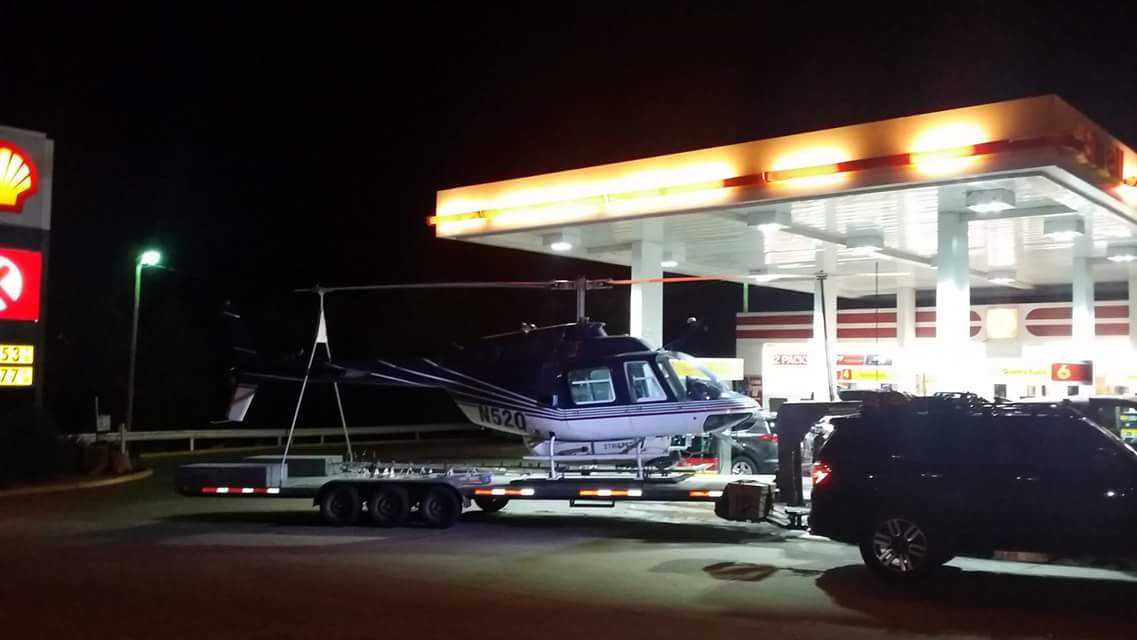

On the way back from FJ Summit last year, I saw this Helicopter at a gas station ( which was pretty unusual) so I pulled up next to the truck and took the pic at an angle that I later noticed looked like it was being towed by Morena. :caked:
Undetectable internet sarcasm... I'd say that 206 Jet Ranger would exceed the couple hundred pound operating limit of your roof rack.
