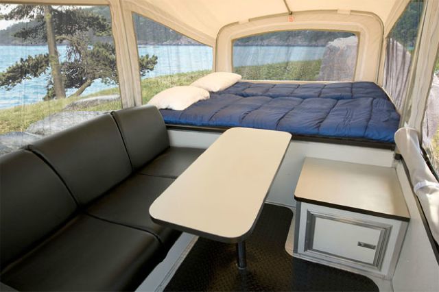

Check these guys out:
Moby1 XC ? Moby1 Expedition Trailers LLC
Lighter weight, not as bulky. The wife and daughter can sleep inside, you can sleep in the rtt on top. Ive been looking at them... Really well made, just have to wait for the little one to get a bit older (only 11mo). You won't need the v8 for it either, just get a super charger, you'll have plenty of power. Cheaper, way easier, and quicker install.
Livin Lite 6.0 QuickSilver Sleeps 4, has table and weighs 400lbs....and for about $6k new...pretty good option
I would trade my expo trailer for this one pretty darn quick...
I've seen these all over the place online. They look cool. My problem is the tent portion of it. The whole reason my wife doesn't want to do a ground tent is because it's a tent. I asked her about these and she said it's just a tent, only farther of the ground. She said the same thing about the RTT.
