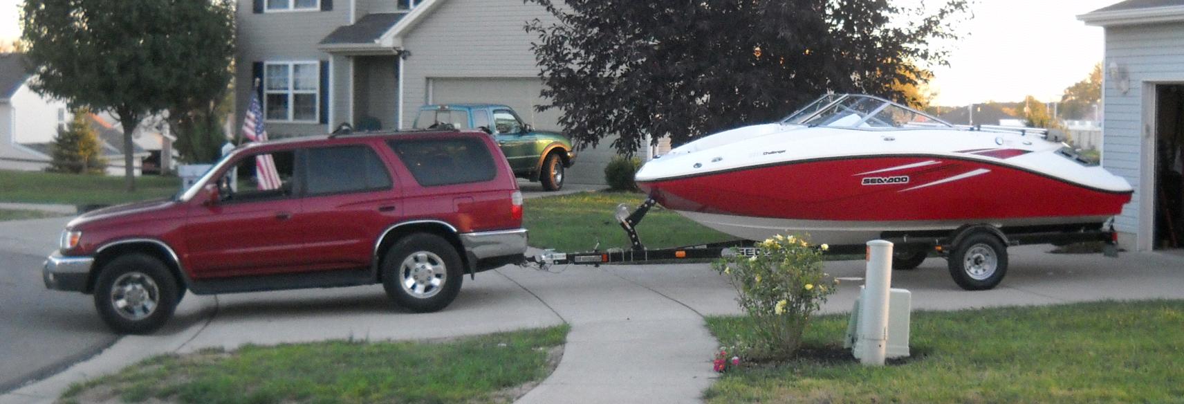

I own a 2000 Toyota V6 SR5 4WD and recently bought a boat. The weight of the boat, trailer and gear is less than 3200lbs. It typically gets towed about 20 miles (half highway, half back roads). So I have 2 questions:
1) Would you recommend a transmission cooler for the 4runner? I have had transmission problems in the past, and had a new trans put in 3 years ago.
2) Would you recommend adding brakes to the trailer?
Thanks in advance,
Keith
PS: They look great together!

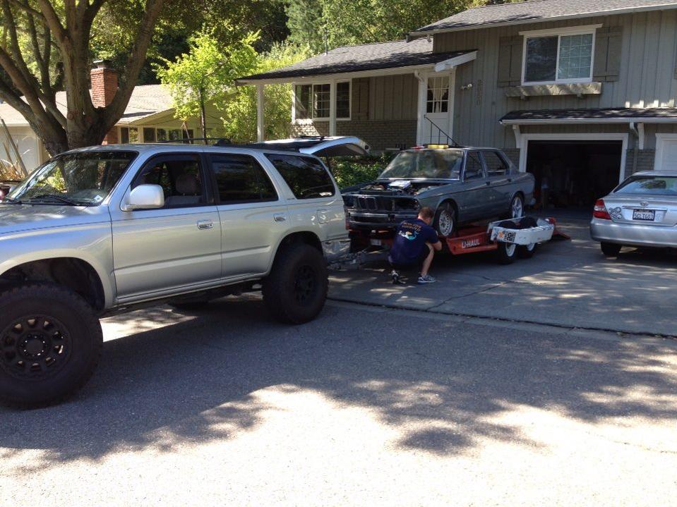

2001 4runner 186k. Mods: air lift 1000 + Monroe load leveler shock/springs in rear, Trans cooler, 4.56 gears with 33's.
U-haul 2200lbs + 3000 BMW=5200lbs towed 200+ miles and got 14mpg. Slow, slow, and very slow but made it without any problem.
