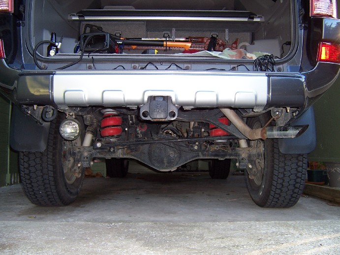

I've towed a 5k# for years with both the Tundra and now my 4runner v8 and I found the 4runner to do a better job (after the air bags were installed). In either case, I couldn't imagine that going up to the 7k# limit advertised would feel stable nor would the suspension comforably tow such a beast.
If you want a big trailer, go with a real full sized truck like a Chevy 2500.
Don't get me wrong, I won't trade my runner in for any other truck, but then again I won't need to tow anything larger than what it's capable of pulling.
With a set of these your forget that AS's back there!

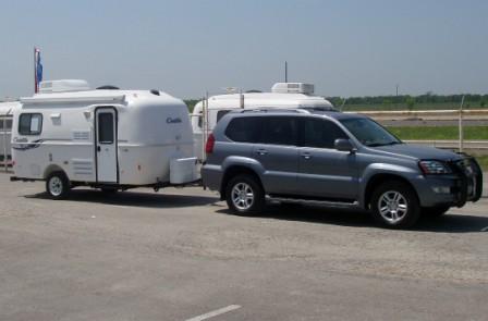

This is a great option. It only wieghts about 3000lb loaded.

You forgot to tell us the model and brand of the trailer. We can't see it from the picture. I want something comparable to the quality of the air stream, because the air stream models are simply too heavy.
