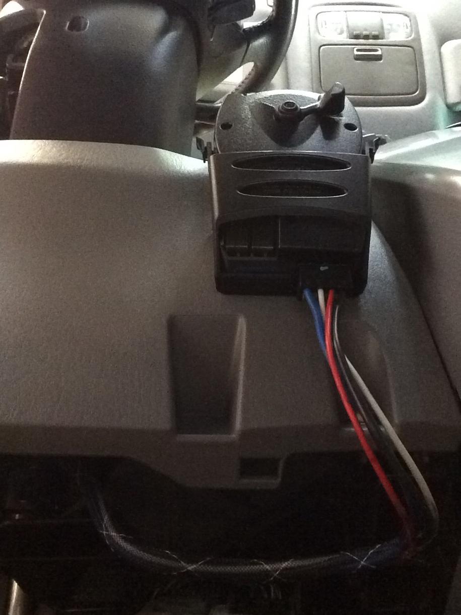

I have a V8 04 and use a Tekonsha brake controller and agree with "most" posts above. In my 04 the plug was on the right side of drivers dashboard which is away from the fuse box which is on the left drivers dash. I didn't check the fuse, but when I plugged it in there was power and I was good to go. In the image below you can see where I mounted the controller and where the wires connect. It's worked perfectly and I have easy access to the trailer brake lever if I need to "brake" the trailer independently of T4R.

^^ This.
Tekonsha Prodigy mounted and wired just like in the pic. I've been towing for many years/miles and this is a great setup.
You can *just* see the controller digital monitor past the steering wheel when you mount it in this spot. Important to know things are hooked up, connected and working.
I have a 2008 just like the OP and the plug is on the left side of the dash by the fuse box. If you are 6'1" like me, you will not want it mounted to the right of the steering wheel like the picture above. Your knee will end up hitting it. In my opinion, the best place to mount the brake controller is on the fuse panel cover itself to the left of the steering wheel. This way, you don't have to drill into the dash, the visibility is much better and there is plenty of room to activate the brake override on the controller.
