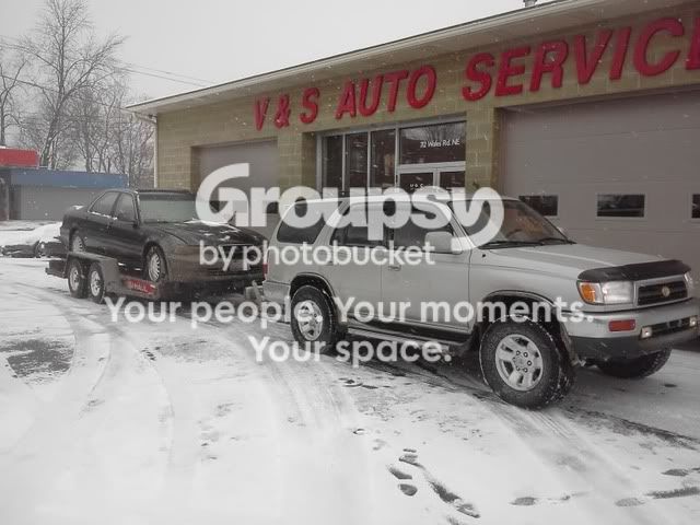

Growing up on the farm I was told "its not what you can tow, its what you can stop". That being said, you still have to be very careful when towing anything, big or small. I honestly think your 4runner will be fine. Those older E30s weigh a little under 3000lbs. If you put it up on a nice, light U-Haul trailer you'll be fine. Just give yourself lots of extra braking room and don't ride the brakes. Last weekend I pulled a 95 Acura Legend (3500lb car) home from an hour away with my '97. Pulled just fine.
0211121144.jpg~original
Several people have hauled cars with their 3rd gen and the 4th gen is a little heavier stronger. Most rental car haulers will have surge brakes so no need for electric brakes. If you are getting your own car hauler then get it set with electric brakes and a good brake controller. Personally I would not have an issue towing a car hauler trailer every once in a while. In fact one of the 3rd gen guys(stick Figure) pulled a car trailer loaded with car and other supplies for a 1200+ mile trip.

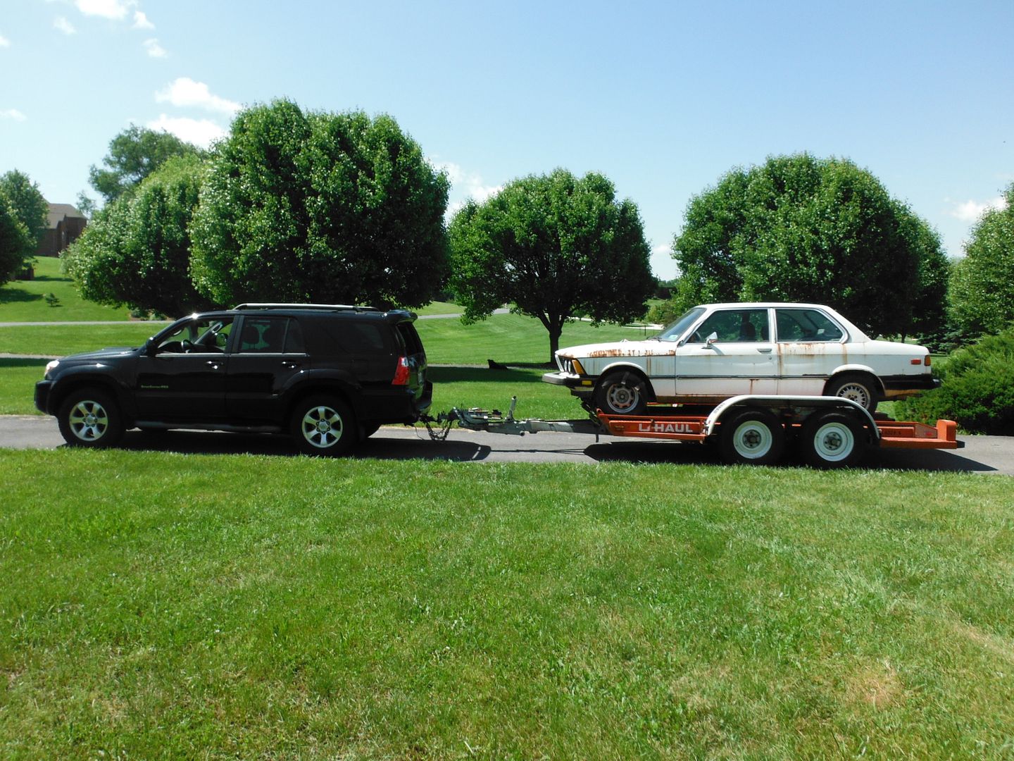

just stumbled on this old thread and figured I'd chime in just for posterity, since I"m towing an e30 325e race car on a 1500lb open-deck trailer (with electric brakes) this weekend 4 hours to the track.
Anyhow, last month pulled a 77 e21 (about 2400lbs + a spare set of wheels) back from W.Virginia, on a UHaul trailer (they are about 2200lbs empty). Tow was easy with no issues - My 08 V6 was totally stock except the tires (Revo 2s).
I'll be running a brake controller and tranny cooler for the tow next week, though.
